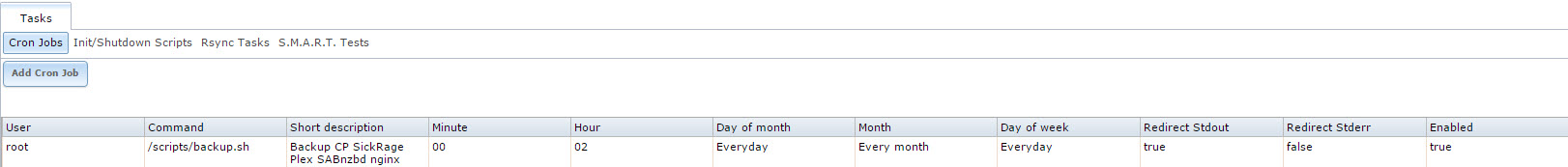

it looks like I'm getting a cron error /scripts/backup.sh not found. I changed the lines for
mkdir –p /mnt/v1/scripts /mnt/v1/backup/FreeNAS/CouchPotato /mnt/v1/backup/FreeNAS/SickRage /mnt/v1/backup/FreeNAS/SABnzbd /mnt/v1/backup/FreeNAS/nginx/ /mnt/v1/backup/FreeNAS/Plex
to
mkdir –p /scripts /mnt/v1/backup/FreeNAS/CouchPotato /mnt/v1/backup/FreeNAS/SickRage /mnt/v1/backup/FreeNAS/SABnzbd /mnt/v1/backup/FreeNAS/nginx/ /mnt/v1/backup/FreeNAS/Plex
and
cd /mnt/v1/scripts to cd /scripts to put the scripts into a subdir /scripts in the root so it can be found.
NasKar
Jan 8, 2016
739
I did it because I got the error "/scripts/backup.sh: not found in an email after the cron job ran. Originally I had it in the /mnt/v1/scripts directory but after moving it to the root I got the same error. I'm not sure what I'm doing incorrectly. BTW I'm not familar with how to use snapshots so I thought this would be easier <G>.

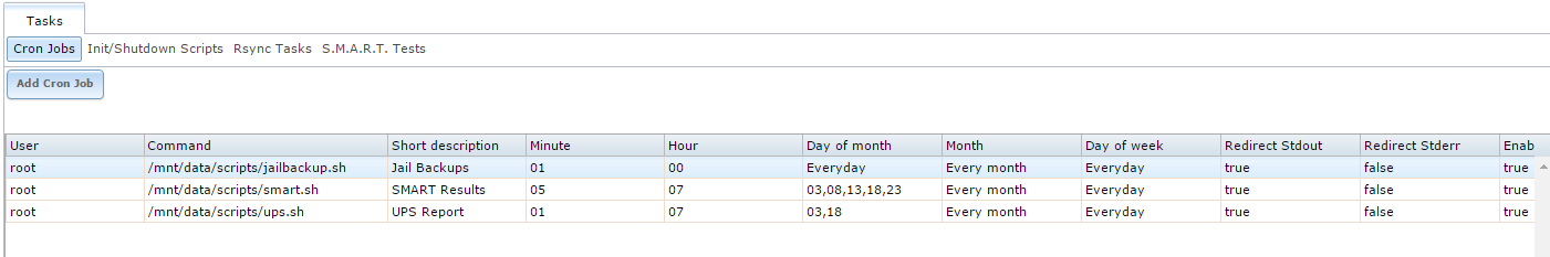

NasKar you probably didnt change the name of your pool/dataset. His is named v1 which is probably not the same as yours or maybe it is. However mine is labeled "data". Also I use RSYNC to backup these directories which only copy's the data if it has changed.
just replace "cp -aR" with "rsync -rv"

Steve Brown I'm not familar with Rsync but will look into it. Do you have it run a script from a cron job? My cron job isn't working I'm not sure why but I can run the script manually.
Steve Brown
May 7, 2015
80
Yes I have it run on a cron...
here is my cron setup.
here is my script .. well the meat of it which is all you really need. The " Quotations are not needed " I just had them there just incase there was a space in my directory structure.
