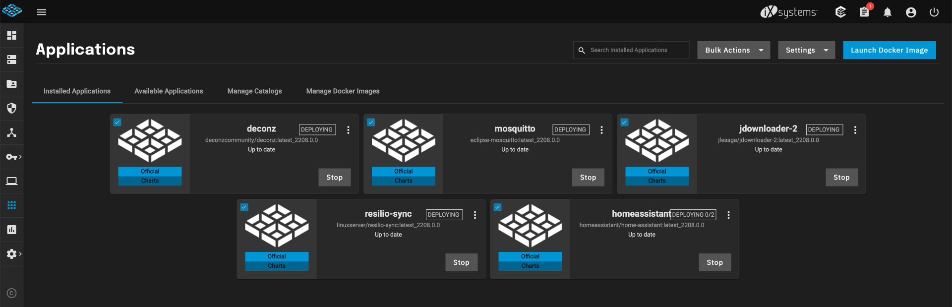

I updated today to Bluefin RC1 but now all apps are stuck at deploying state? I already tried stop/start and whole system reboot but no change ...? Also no Shell / Log output ...

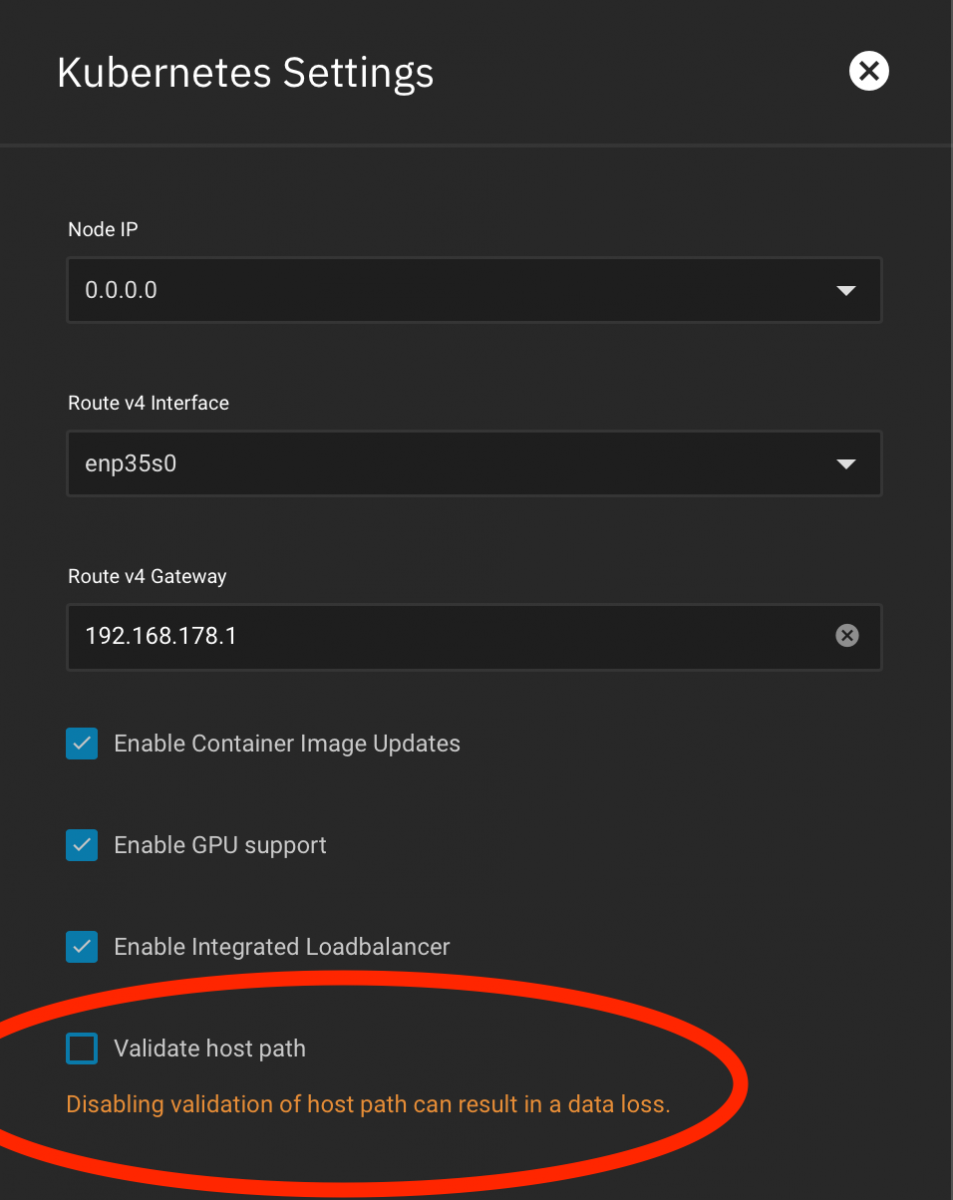

Awesome ... yes that was the solution! I deactivated the kubernetes setting:

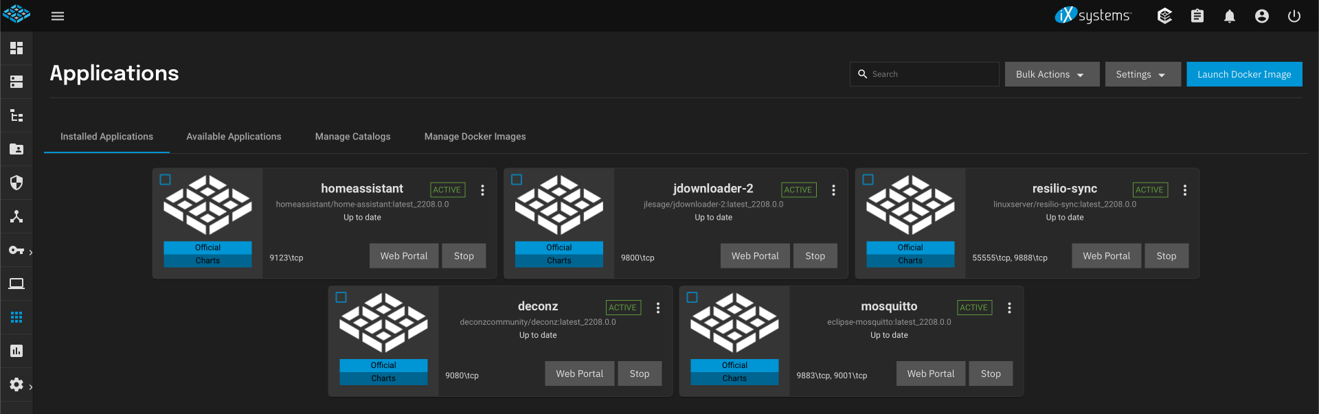

Now all is up again ... plus the Web Portal Quick Link addition in bluefin is quite helpful! :)
... since I access / edit most of my docker container shares via SMB I have to always leave that feature disabled if I understand correctly?

pixelwave
Jan 26, 2022
174
This Fixed my issues as well!
@pixelwave Are you doing driect connect 40GB/s or are you running a switch?
Currently direct connect. I have a main 1 GBe connection to the TrueNAS server and a secondary 40 GBe that goes directly to my Workstation. When I need that fast file transfer I attach a drive via the IP of the 40 GBe NIC…
Switch upgrade is planned …
