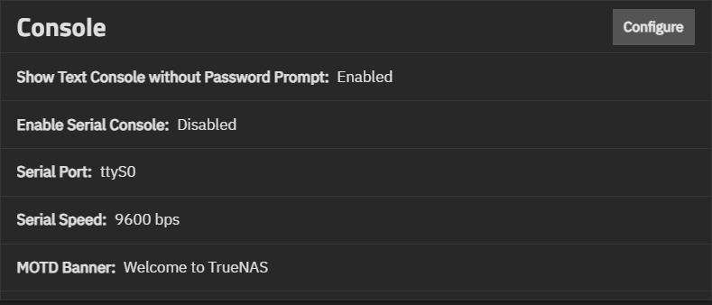

The Console widget shows the current console settings for TrueNAS, which cover setting a password prompt for the text console, enabling/disabling the serial console, the current serial port number and speed, and any banner text entered in the MOTD Banner field.
Configure opens the Console configuration screen.
Console settings configure how the Console Setup menu displays, the serial port it uses and the port speed, and the banner users see when accessing it.

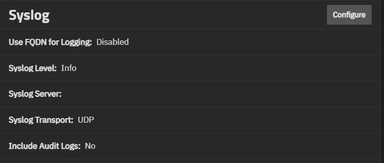

The Syslog widget displays the existing system logging settings that specify how and when the system sends log messages to system log (syslog) servers. TrueNAS allows configuring an array of two syslog servers. Each server can have its own host, transport, and TSL certificate setting.
Configure opens the Syslog configuration screen.
The Syslog settings specify the logging level the system uses to record system events to the boot device. Sets whether to use a fully qualified domain name (FQDN) for logging, and if audit logs are included. There is also an option to configure a remote syslog server for recording system events.

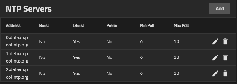

The NTP Servers widget allows users to add Network Time Protocol (NTP) servers. These sync the local system time with an accurate external reference. By default, new installations use several existing NTP servers. TrueNAS supports adding custom NTP servers.
The Add NTP Server screen shows Network Time Protocol (NTP) server settings that sync the local TrueNAS system with an accurate external reference. By default, new installations use several existing NTP servers. TrueNAS supports adding custom NTP servers.
Add on the NTP Servers widget opens the Add NTP Server screen.

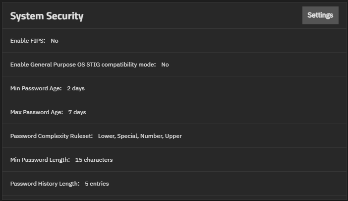

The System Security widget allows administrators of Enterprise-licensed systems to enable or disable FIPS 140-2 compliant algorithms, general-purpose OS STIG compliance, and other administrator account rules. Changing FIPS or STIG settings requires a system restart to apply the setting changes.
High Availability (HA) systems restart the standby controller and then show a prompt to failover and restart the primary controller.
Settings opens the System Security configuration screen.
The Enable FIPS toggle enables or disables enforcement. The Enable General Purpose OS STIG compatibility mode toggle enables or disables the STIG compliance implementation. Requires two-factor authentication for an admin user with full permissions before enabling STIG compatibility.
Administrator Password settings
Name Description Min Password Age Minimum number of days a password must be used before it can be changed. Max Password Age Maximum number of days a password can be used before it must be changed. TrueNAS warns users of password expiration seven days prior to the set expiration date. Password Complexity Ruleset Defines the required character types for administrator passwords. Choose between Upper, Lower, Number, and Special character type requirements. Min Password Length Define how many characters must be present in an administrator password. The default required minimum is 8 characters. Password History Length Define how many previously used passwords to remember. Prevents administrators from reusing passwords when updating credentials. Requires an integer between 1 and 10.

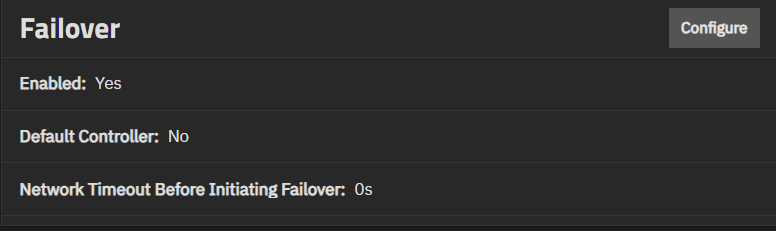

The Failover widget shows only on Enterprise-licensed HA systems. It shows the status of failover, the default controller, and the network timeout before TrueNAS initiates failover.
Configure opens the Failover configuration screen.
The Failover screen shows settings used on TrueNAS Enterprise (HA) systems to turn the failover function on or off, sync the primary and standby controllers, and allow administrator users to configure failover. The main menu option and screen only display on Enterprise (HA) systems with the correct license applied.
Setting Description Enable Automatic Failover Set the system to turn on failover. Leave clear to disable failover. Default TrueNAS controller Sets the current active controller to be the default controller when both TrueNAS controllers are online and HA is enabled. To change the default TrueNAS controller, leave unselected on the default TrueNAS controller and allow the system to fail over. This process briefly interrupts system services. Network Timeout Before Initiating Failover Sets the number in seconds to wait after a network failure before triggering a failover. The default value is 0, which means failover occurs immediately or after two seconds when the system is using a link aggregate. Sync To Peer Initiates a sync operation that copies over the primary controller configuration to the standby controller. Opens the Sync To Peer dialog to confirm the operation. Sync From Peer Initiates a sync operation that copies over the standby controller configuration to the primary controller. Sync To Peer and Sync From Peer buttons each open a confirmation dialog before TrueNAS performs the operation requested.
Setting Description Reboot standby TrueNAS controller Select to cause the standby controller to restart after the sync operation completes. Confirm Select to confirm you want to perform the sync-to-peer operation. Proceed Begins the sync operation.
