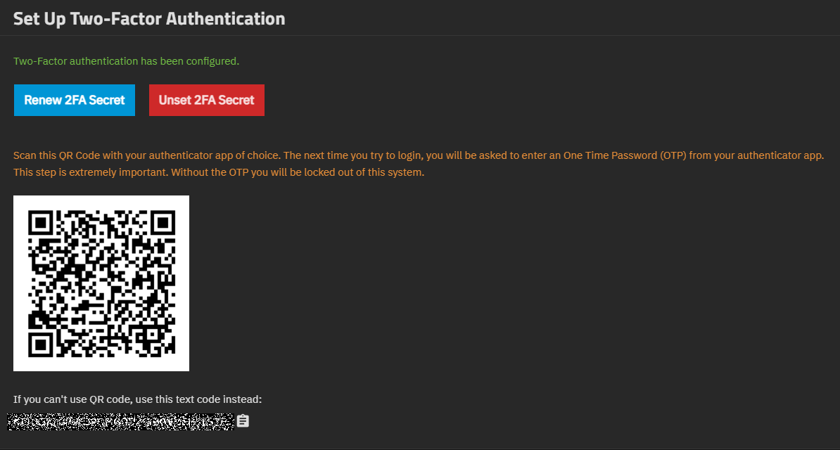

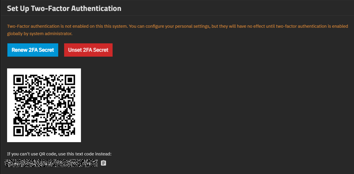

    You can also access the two-factor authentication settings for the currently logged-in user from the Settings option on the top toolbar. Click the Settings icon, then select Two-Factor Authentication to open the User Two-Factor Authentication Actions screen.
    Click Configure 2FA Secret to open the Set Up Two-Factor Authentication screen and view the QR code. The Set Up Two-Factor Authentication screen also has the unique key with a copy to clipboard button so you can configure 2FA using a non-camera method if necessary.
    You can configure two-factor authentication and get the QR code for an authenticator app for the logged-in user at any time, but you must configure global two-factor authentication to enable it.
    When using Google Authenticator, set Interval to 30 or the authenticator code might not function when logging in.
  3. Click Configure 2FA Secret to open the Set Up Two-Factor Authentication screen where you scan the QR code using Google Authenticator or copy the unique key. To generate a new QR code click Renew 2FA Secret.
    After scanning the code click Finish to close the dialog on the Two-Factor Authentication screen.
Accounts that are already configured with individual 2FA are not prompted for 2FA login codes until Global 2FA is enabled. When Global 2FA is enabled, user accounts without 2FA settings configured see the Two-Factor Authentication screen on their next login to configure and enable 2FA authentication for that account.
