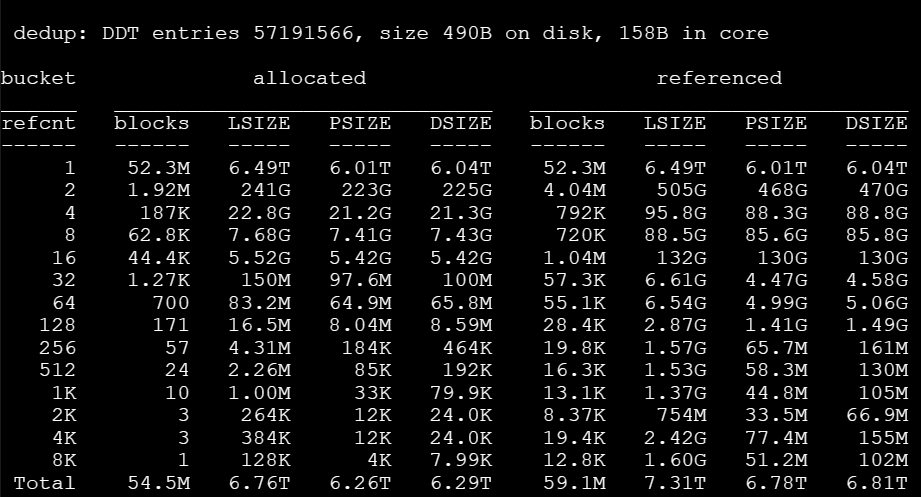

zpool status -D, interpreting the table?
jenksdrummer
Jun 7, 2011
250
I've kind of guessed my way of interpreting the output of the above command but would like something more concrete as to what the columns are stating.
Example output of mine:
Overall, it's a 1.08x deduplication rate, which, by contrast, with this same data on a Microsoft ReFS volume w/ Deduplication enabled, instead hovers around 20-21% deduplication; however on ReFS; that data is not compressed as I am doing with ZFS; so it's probably a bit of a mixed bag / trade-off. (1.08x compression x 1.08 deduplication is about an overall 16.5% reduction)
I more or less look at the bottom of this and compare DSIZE, with 'allocated' equating to actual / as-written, where 'referenced' is more as to what it is if there was not deduplication. But what am I really looking at; can someone break this down for me or give me a link? Seems what I have found so far has been just recommendations about not deduplicating data because of the performance hit, but my array is SATA SSD based, with a mirrored pair of NVMe being used for the special VDEV...so performance hit isn't that spectacular; though, truth be told here, the deduplication rate also isn't that spectacular...so I regularly debate if it's 'worth' it...lol

Tx. Scenario is home lab; personal data.
Supermicro 5028D-TNT, 128GB ECC RAM
6 WD Red SATA 4TB disks, Z2
2 Samsung 970 Evo Plus 1TB NVMe on Supermicro 2-port AOC NVME PCIE card (bifurcation): Special VDEV, Mirror
1 Samsun 970 Evo Plus 1TB NVMe on board, Cache VDEV
I realize the compression vs dedupe debate has been going on forever, but since special vdevs became available in FreeNAS, I've been using them and been happy with the performance of having deduplication on...before it would make a system near unusable after some magic threshold.
Same with the debate over using USB boot these days; buy a slew of them from a reputable maker, mirror them out, and it's not that big of a deal if one pops. ;)
What I was really after was some clarification as to the layout of the table. Apologies this likely reads as unappreciative.

there aren't all that many people using dedup. it's largely new territory and your mileage will vary.
it looks to me like you are interpreting the table correctly, and it's telling you part of why dedup isn't used. most of the time it gives the same as compression, and then 3 years down the road becomes so useless and slow, because it's fast to start with as as there is more and more data and dedup tables it gets more and more bogged down.
