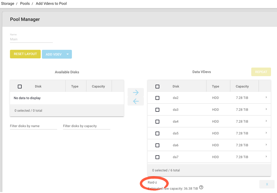

Hi there, I am new to TrueNAS and I have a similar issue. I am running TrueNAS-12.0-U8.1 and I want to expand my raidz1 pool with a new raidz2 vdev, but the GUI will not allow me to select raidz2.
English is not my first language, so I don't know if I'm describing this correctly. Here's a picture of what I'm trying to do:
But I can't click on the "Raid-z" text to change it to raidz2:
Is there a way to do this via the TrueNAS Shell, and if so, what are the steps?
Also, assuming I'm stuck with radiz1 for both the old and the new vdev, does that mean that each vdev can lose one drive each before data loss, or that BOTH vdevs can only lose one drive between them?
