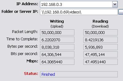

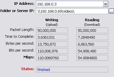

Hi guys, I couldn't wait till the weekend and ran some server side LAN speed tests to my little NUC's SSD at 5Ghz with AES. Generally the upload was about 20Mbps faster through the walls and 50Mbps faster directly in front. I have looked at some other posts and generally 50Mbps is thought to be enough to stream 1080P.
Through 2 plaster walls at a distance of about 3M:
Directly in front at 1M:
I am wondering the difference in LAN speed when it's client side driven as opposed to server side driven. Also the router will be moved into the lounge area and have direct LOS to the entertainment room but will be 8M distance as opposed to 3M.
