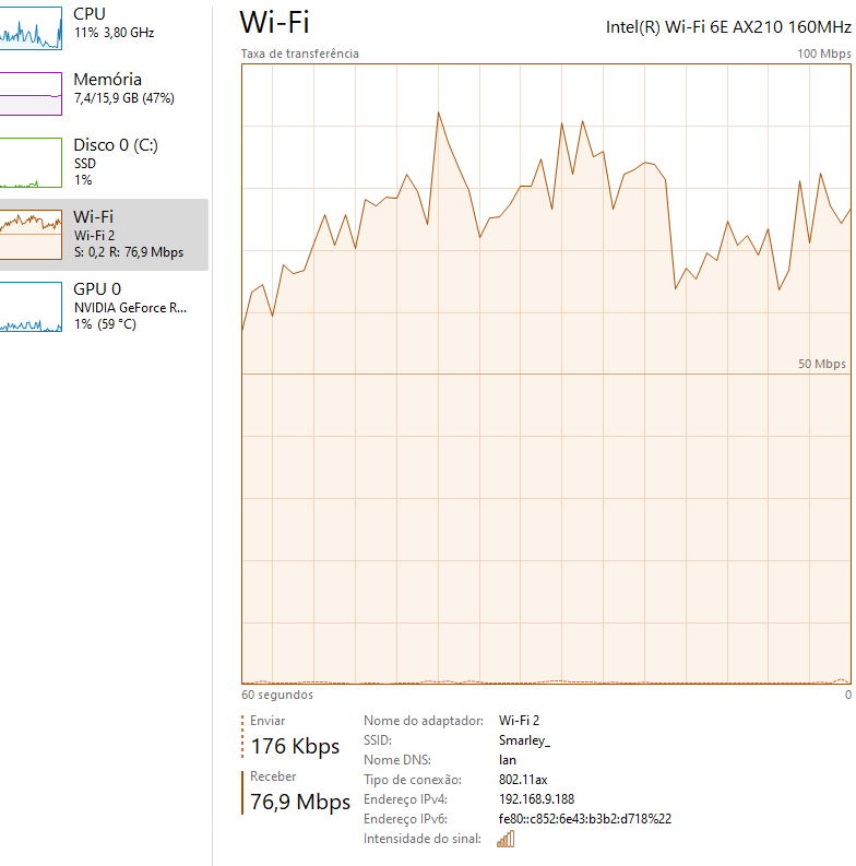

This is the transfer with FTP:

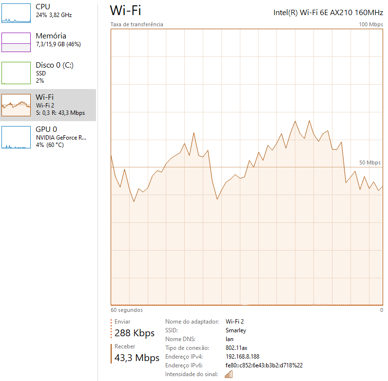

And this is with FTP (using local ip of server) via Wireguard:
Same package of files.
Obs: this files I can get around 300Mb with cable.
