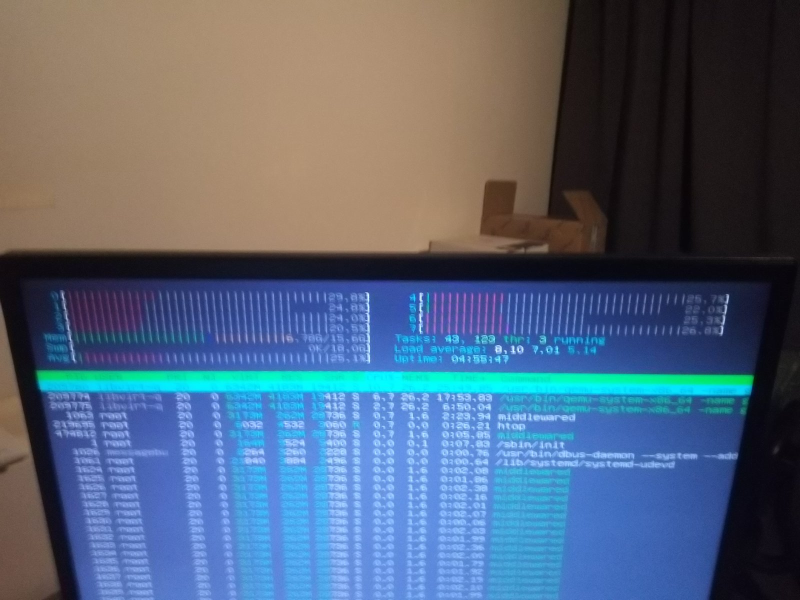

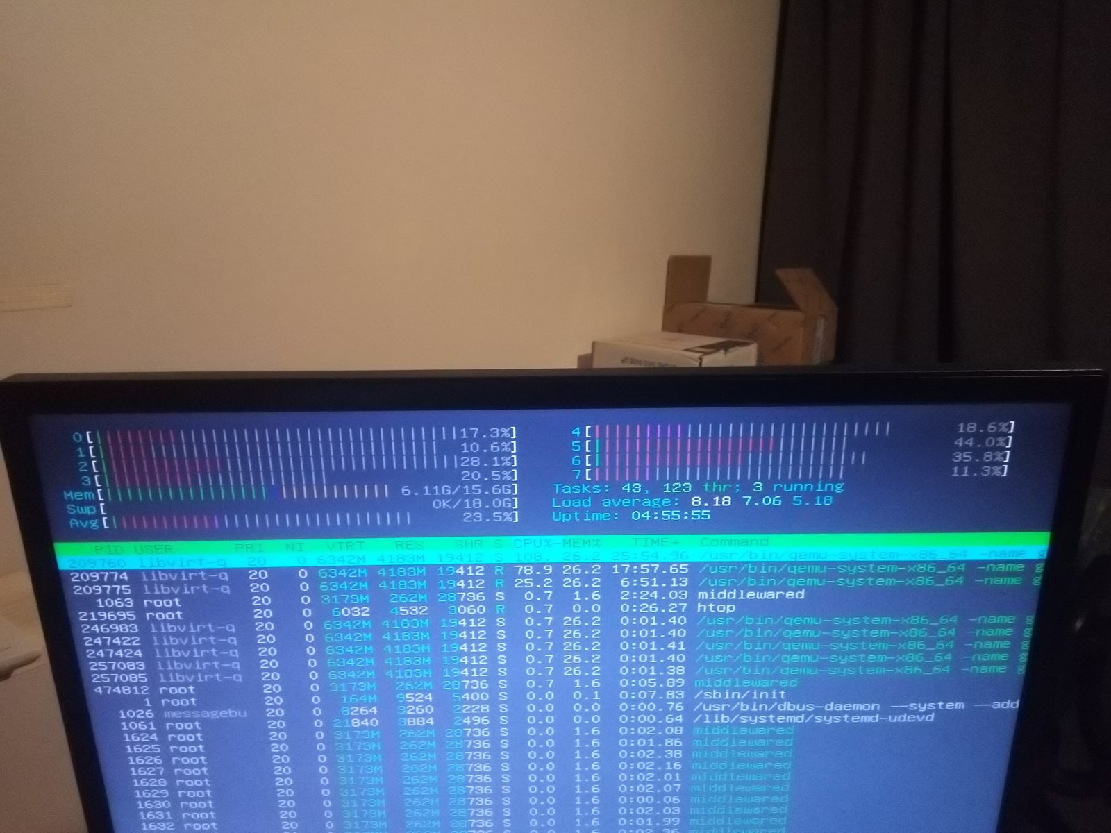

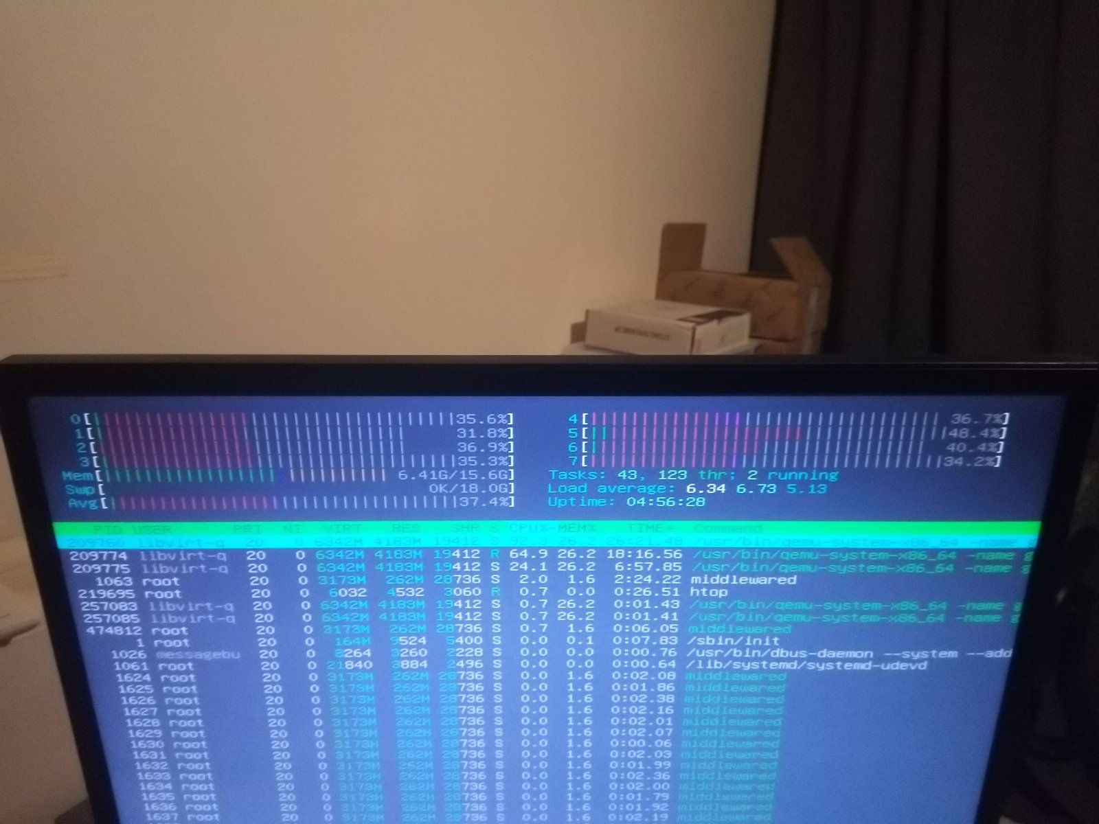

I have made some test.
I have put the NIC and data disks to VirtIO.
Now I have a copy speed up to 85MB/s and it's a good news.
However, I have again some very high CPU usage... It's less frenquent and under 100% but I think it's too much for only 1VM using 2 core of 8...
You cansee attached 3 pictures of htop displaying iowait in grey.
Is it normal ? caused by ZFS core ? or there is again a mistake ?

9,700

I think the best guess is IO bottleneck manifesting in CPU stuck waiting for blocks to arrive.
Do you have an SSD you can try with? that should eliminate the IOPS question.
