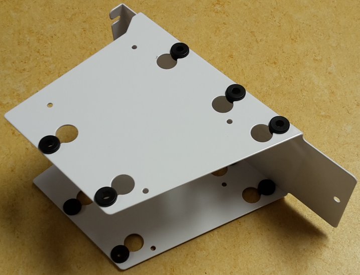

To help resolve this discrepancy pertaining to the Fractal Design Node 304 HDD cages and just in case someone else but me was surprised about Stux' statement (and maybe also about the pictures in this posting from Stux' build report, at least on second glance):
As the Fractal Design Support confirmed on my request, a modified revision of the Node 304 (starting with production week 51/2014, serial number begins with 5114 or higher) exists and has the following changed properties
  • HDD Cages which are also suitable for the new HDD bottom screw hole positions
  • three instead of two recesses on the side braces to fit the new HDD cages
Old ("not extended") Node 304 HDD cages, suitable for legacy HDD bottom screw holes:
http://www.fractal-design.com/media/8e32e77c-2d0a-40a7-b7c1-c24f7ea3d66f
New ("extended") Node 304 HDD cages, also suitable for "alternate" HDD bottom screw holes:
