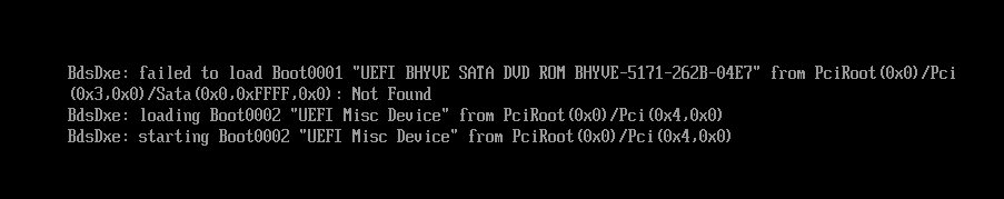

I have trid to make multiple win installs but none are stabel.
the most stabel i this setup under with virutel IO and windows 10 pro
but it almost always crashes but noe being responsive over the truenas VNC connection or over extrenal desktop connecttion on windows.
is there som changes that i need to do to get it stabel?
i also isnt booting on server startup, so i have to starte the truenas vnc to make it boot. is there something i havent configuered correctly?
i get this on boot, is this ann issue?

Did you install VirtIO drivers in the Windows VM?
Pelle84
Jan 19, 2023
14
i did it under install to get the patision and i have runed the virtio-win-guest-tools and installed that.
