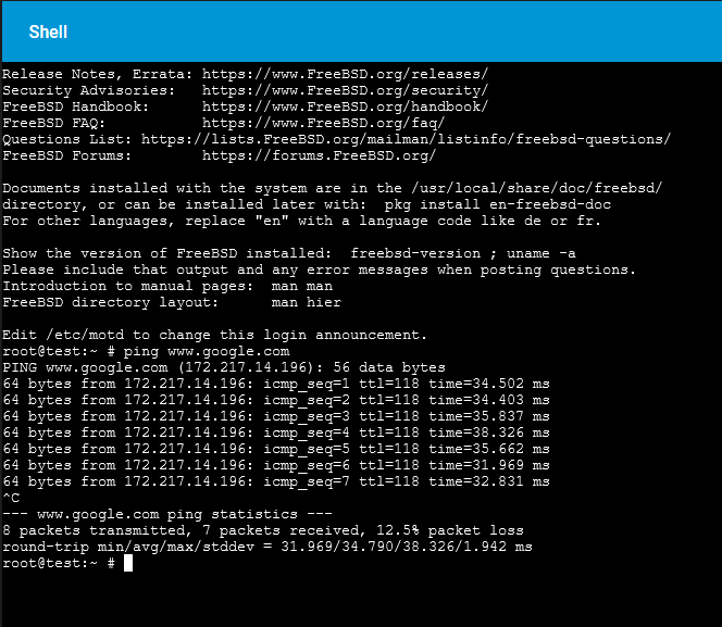

I looked at that thread, and I have nothing to add there. I remember something being a little off when I first setup the jails, but I got it working in a way that seems like what you are having trouble with, but I dont remember enough details about it.

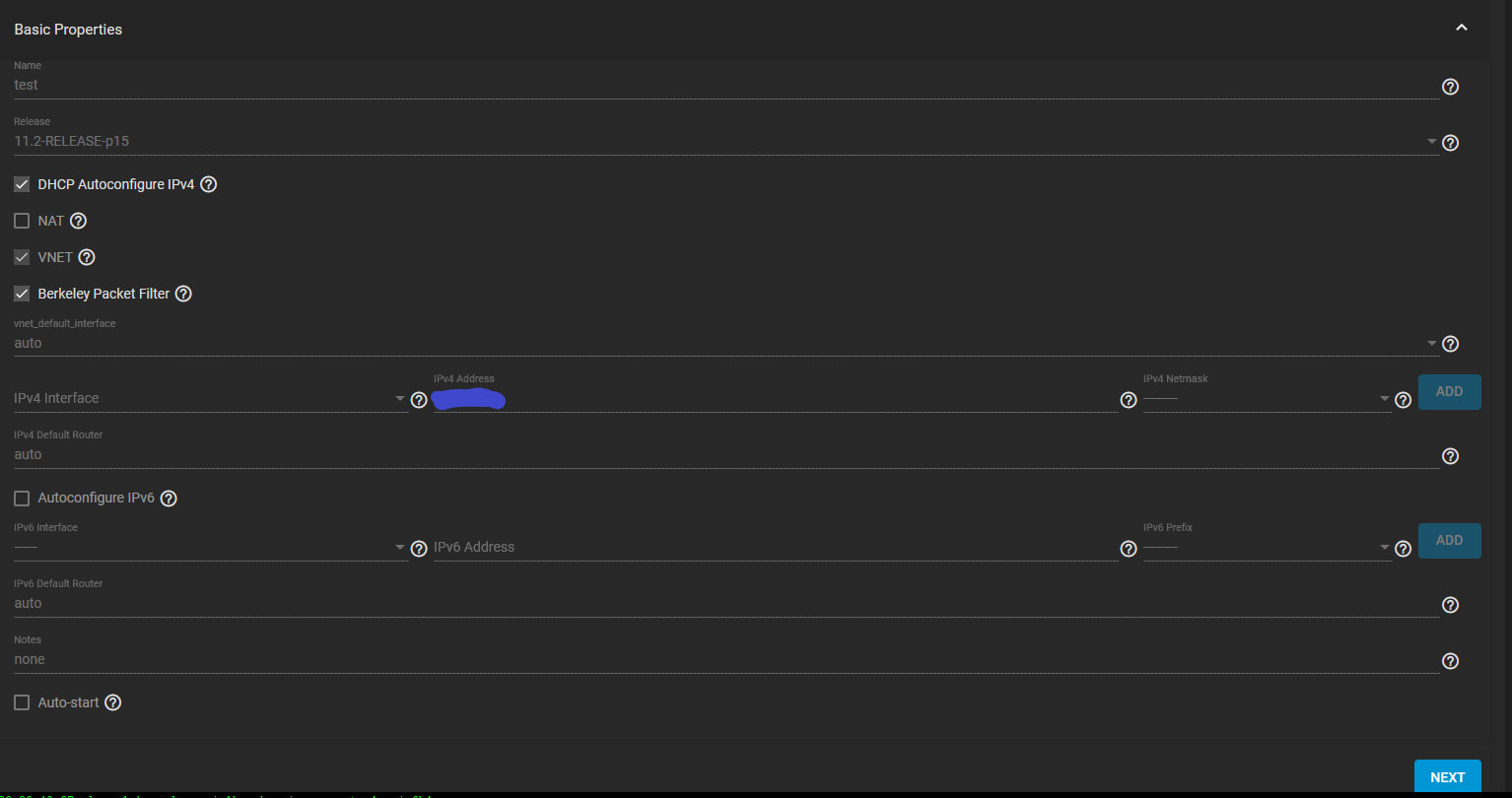

I slapped together a new jail, simply hit DHCP, VNET, and auto interface, and the jail can ping google.
Im using pfsense as well.
the trueNAS/freeNAS/SCALE version should be in your system config. are you using an old version or anything? as I was creating this test jail, I definitely remember having issues, but that was a long time ago.

I'm using TrueNAS Core 12.0-U8, I just put latest because it will change and I will forget to update it.
In the GUI if you choose DHCP it auto selects VNET and BPF as well and won't let me continue without all three.

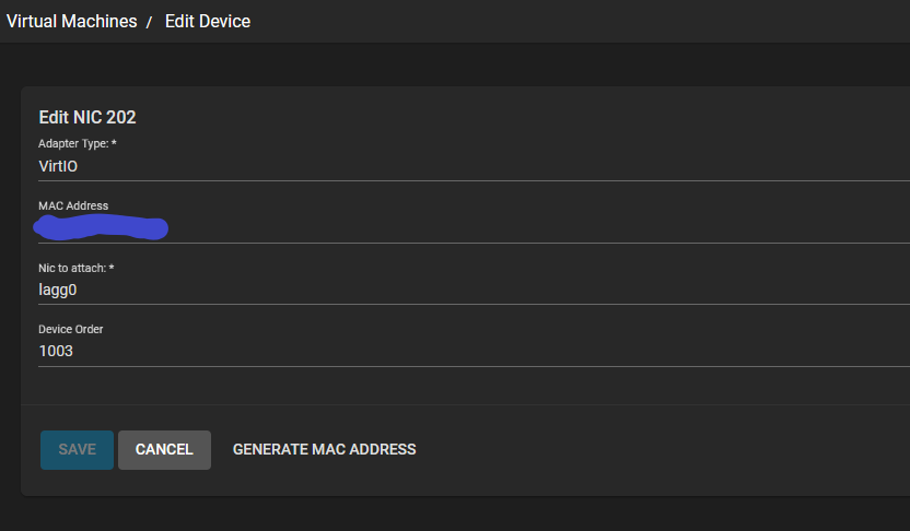

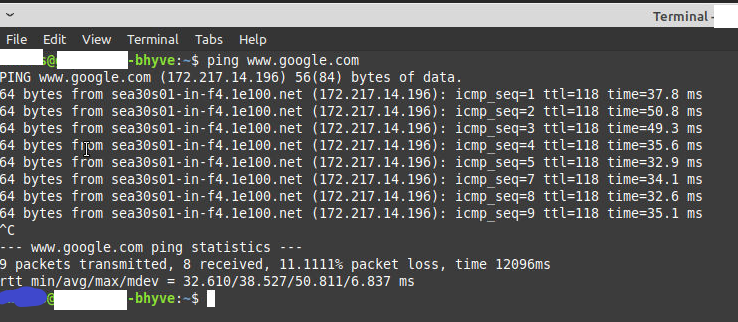

I thought I might sidestep this rigamarole my spinning up a VM and using Docker and NFS but the interface it spins up also does not get an IP so no internet.

probably wont help but, eh, here are some screenshots. the vm is linux mint

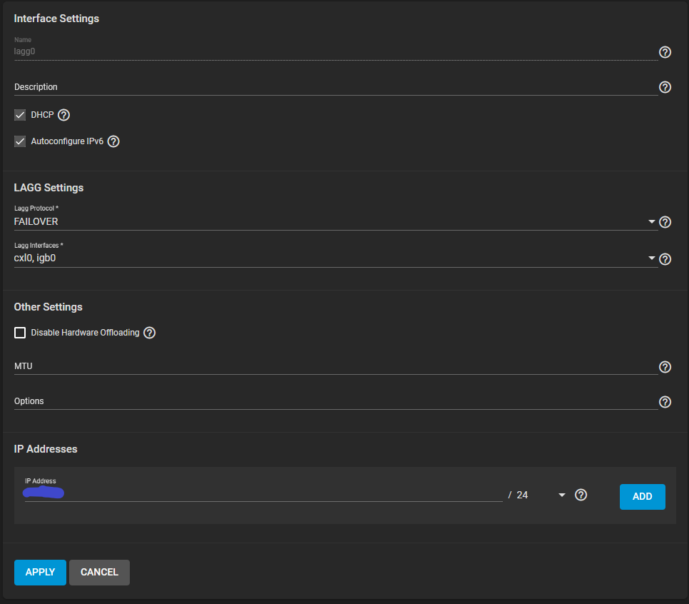

Problem solved turns out it was setting the LAGG to load balance, once I switched it to fail over everything is working fine and as it should. SOLVED!

Are you using lagg without an LACP capable switch? Don't :wink:

I thought when I bought the switch it was LACP capable, I'll have to look into it further. But now that I know that it can cause your jails and VM's not to work it's really not worth the trouble enabling lagg. I was under the impression that I could be copying lots of files over scp or video to the server while the other port could handle serving everyone else in the house. If I looked into it would probably find that I wasn't even saturating one of the ports half the time.
Hours lost lesson learned won't be doing that again any time soon.
Patrick M. Hausen
Nov 25, 2013
7,776
The main point even with failover or loadbalancing instead of LACP is that ethernet channel bundling is something that in most cases must be actively configured and maintained on both ends of the connection. You cannot enable a bond/lagg/port-channel only on one side and expect that to work.
Even with ESXi that does not support LACP without the distributed vSwitch feature you must configure the port-channel on the other end, e.g. Cisco (which is what I mostly use).
