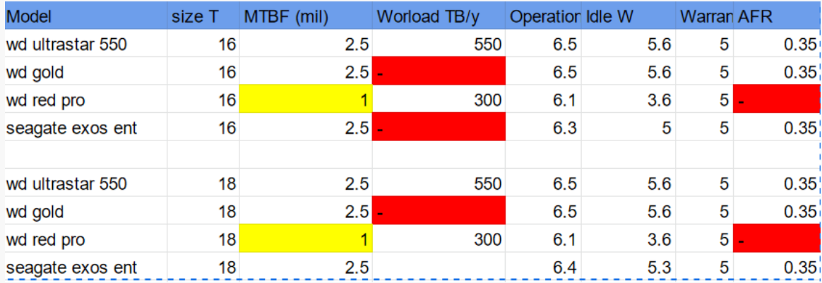

hello,
these drives are almost same by spec... i think exos or ultrastar even better by MTBR better, even redpro and gold costs maybe by 100-150 euro more, any idea why?

Etorix
Dec 30, 2020
2,134
Different markets, different pricing strategies: Red/Ironwolf = consumers (sold by the unit); Ultrastar/Exos = enterprise (sold in bulk, with build-in bulk discount). As far as I know, since WD bought HGST, WD Gold are merely Ultrastar with a WD sticker (and the same 3.3V_PWRDISABL behaviour…).
Get the cheapest, and don't bother mixing and matching unless you're willing to spend more just to try and avoid that the drives come from the same factory batch.
