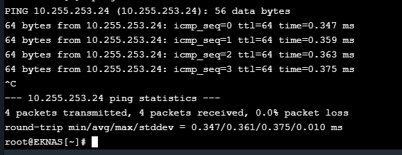

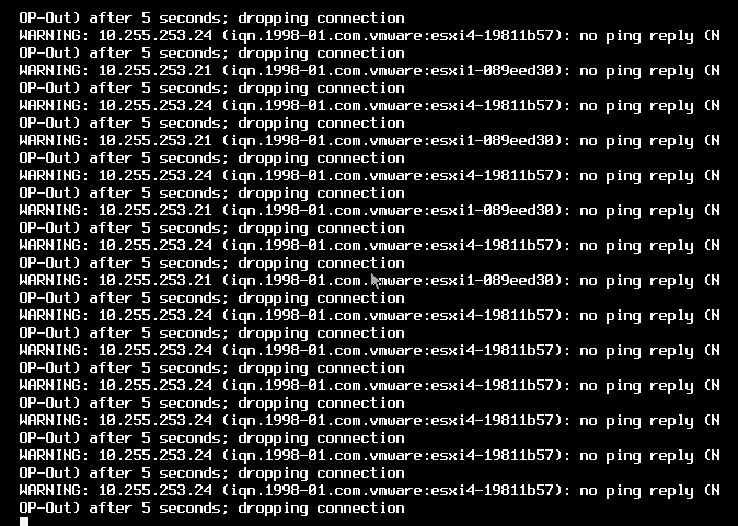

Also noticing that the console is being flooded with a generic message about ping availability however I am able to ping the addresses in question with 0 issue from the FreeNAS shell.

Finally got it fixed, the timeout error was a typo on MTU size for a single interface in one of the paths - then I was able to repair the file systems. Still need to figure out what actually happened and how to prevent this in the future/before rolling back to U5, but at least i'm back up!

@jgreco Thank for for the info, the no ping reply message was found to be a single port that had a bad MTU setting which was catching some of the traffic and causing that issue. After correcting that port it was resolved.
