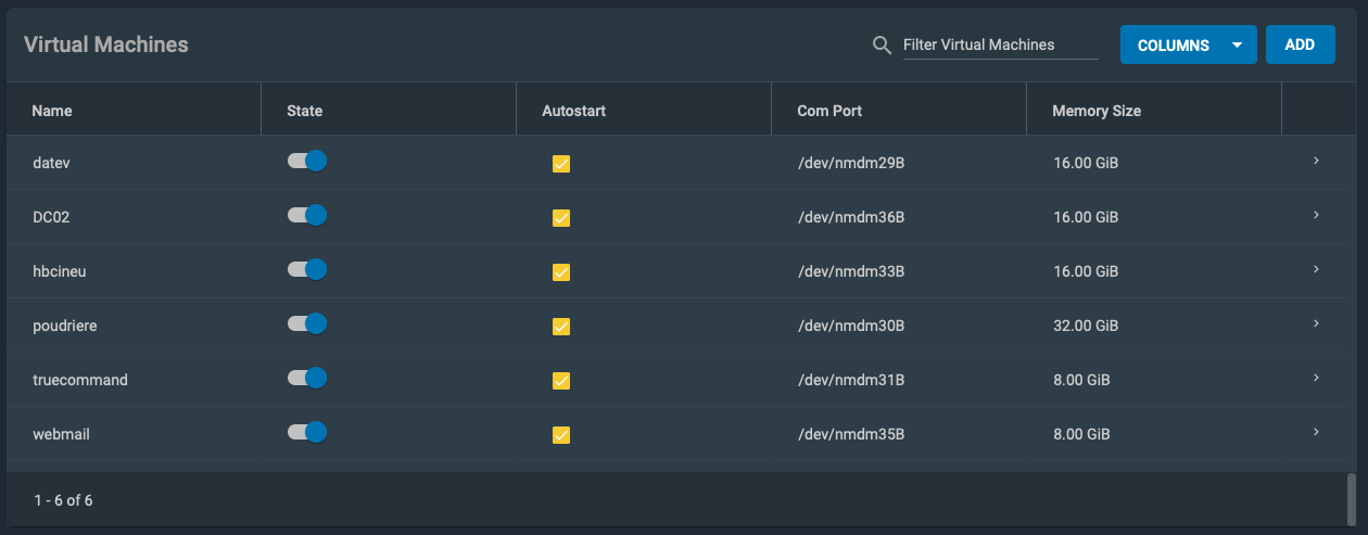

If you look at the configured memory of all VMs, it's 96G in total:

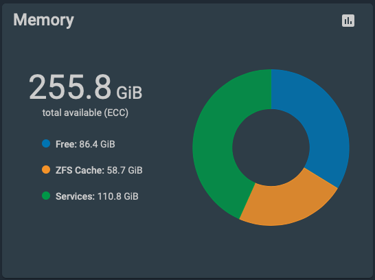

And the host system has got a whopping 256G. Additionally I limited the ARC to 64G via sysctl:

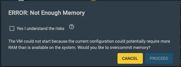

So I have 86G free, I try to start a VM with 16G configured, and TN warns be I would be overcommitting memory? Why? We do not run any other service but VMs on these systems.
