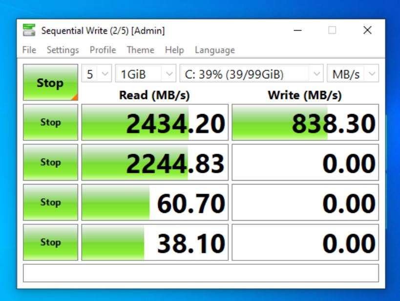

I also have a lot of issues with responsiveness, I've tried Ubuntu and Windows 10. I have my VMs on mirrored sata ssds, and CPU performance seems fine. Just really chugs when trying to access files. I think I've narrowed it down to the disk speed in my case. When running Crystal Disk Mark it gets about this far before it completely locks up the system.

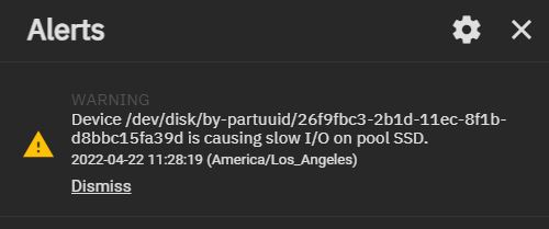

After a little while of sitting here the windows 10 VM locks up completely and Truenas throws this alert:
I would greatly appreciate any recommendations and I'm curious if I'm seeing the same issue as OP. Running a crystal disk mark test should validate if it is.
