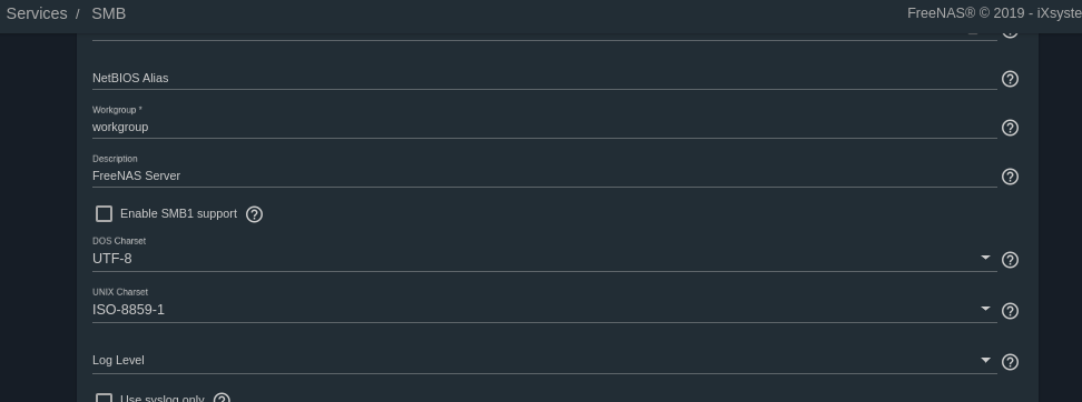

well, i can't tell you if it was in iso-8859-1 what i can say is that the clients that use these folders and change it are mac0s and windows clients but the highest usage percentage is windows. I also took a look at the configuration of freenas but precisely speaking of the configuration of the SAMBA service, and noticed that it is as follows.
NOTE: The users access these directories with service samba.

When i tried change the field UNIX charset iso-8859-1 to UTF-8 the directories that have accent and special characters simply disappeared from the client interface, I got scared and went back to iso-8859-1 and the files came up again.

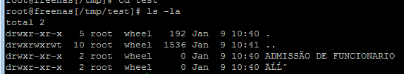

Okay thanks ... My plain guess is that it is actually issue of the session rather than something else. I assume users using these directories sees the name properly over SMB so the main "issue" here is that you don't see it properly when connected to the server CLI.

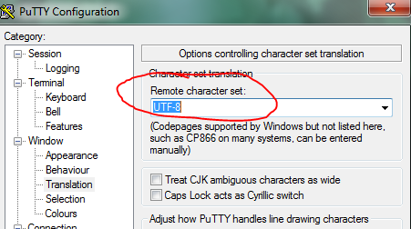

So my next question is "How are you connecting to the server." I mean are you directly connected to console or via SSH? If SSH what is the client. If PuTTy do you have proper charset configured?
If this is the source of the issue i suggest to change the "locale" back to its original values (whatever it was) and use the same set in your SSH client. Then you should be able to see the UTF8 chars just fine ...
UTF-8 set in PuTTy

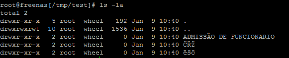

To demonstrate the difference here is the same dir but with 8859-2 ... as you can see the names are screwed and one file is "missing"
And one more comment for the UNIX charset ... you CAN NOT change the charset just like that. If you do so then the charset used for "decoding" would not match the charset under which the files/dirs were created. If you really want to change the charset used by SMB you have to convert all of the files/dirs encoding. To do so you can use convmv which handles conversion. Make sure that you have a proper backup and you know the original encoding as wrong usage of the convmv could cause wayyyy more issues.

Or if you don't want to mess with the locales then you could install the PuTTy and set the connection charset as per the screen in my prev. post.
Thanks for this tip, there are actually years files maybe stored with totally different encodes so it is risky to convert them all.
Well for Linux/Unix clients it should not be issue as SMB converts to whatever is defined in UNIX charset so ISO-8859-1 in your case. Windows makes things more messy (as always) and SMB actually tries to match the charset the client is using while preferring UTF-8. If it fails to match (DOS/Win98/ME era) it uses ASCII (which adds even more screwups for modern days). I assume you don't have any ancient SMB clients (because the back-compatibility with SMB1 is not enabled in your setup) so i really assume you have mostly UTF-8 charset.
So first ... get PuTTy and try SSH with UTF-8. See if you can see the special chars.

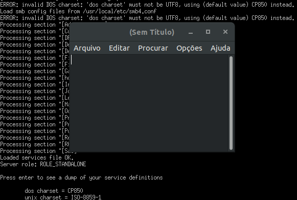

Second ... try following command while connected to your server testparm -v | grep -i "charset" and paste output.
i did install the putty but still unsuccessful in visualization.
The output the command testparm -v | grep -i "charset" are in image

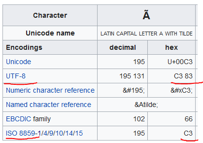

Okay so apparently the UTF-8 is invalid even with GUI allowing that (BUG to be reported) and with this invalid charset it falls to default CP850 (which contains all of the "Latin-1" / 8859-1 chars).
The character à has HEX value "C3" in ISO8859-1 and "C3 83" in UTF-8 which is still OK for this particular one.
So it seems to me that the locale is just screwed...

Assuming you have "pt_PT.ISO8859-1" now set as your locale on the server follow the steps bellow
- Connect via PuTTy with ISO-8859-1 remote charset a do:
locale
mkdir /tmp/test
cd /tmp/test/
touch `echo -e "1test\xc3test"`
touch `echo -e "2test\xc3\x83test"`
ls -la
- Copy (or screenshot) the full console output here (not only results but whole terminal screen including entered commands)
- Change the content of ~/.login_conf to this:
me:\
    :charset=UTF-8:\
    :lang=en_US.UTF-8:
- Regenerate locale by using cap_mkdb ~/.login_conf
- KEEP the connection open, connect with another PuTTy instance but with UTF-8 as remote charset and do:
locale
cd /tmp/test/
touch `echo -e "3test\xc3test"`
touch `echo -e "4test\xc3\x83test"`
ls -la
- Again paste the output/screenshot of terminal here
- Now go back to the first PuTTy instance (here you will still have the 8859-1 lang) and while in /tmp/test call again the ls -la and paste another output here.
Result should be that the 1 and 3 are OK under Latin1 env and 2+4 "broken". The second PuTTy with UTF8 should properly show the 2 and 4 names while 1 and 3 will be scrambled. It works on my end flawlessly but lets see your output.
Anyway in the second PuTTy window (the one with UTF-8 charset) do this:
convmv -f ISO-8859-1 -t UTF-8 1tes*
It gives you this kind of output:
Now call it with the --notest flag
convmv -f ISO-8859-1 -t UTF-8 1tes* --notest
Output will confirm the conversion was done. Now use ls -la and paste the output. You should see 1, 2 and 4 properly while 3 will be still scrambled.
