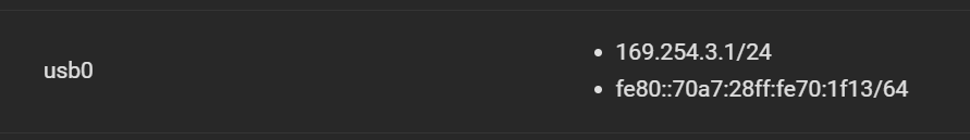

Running TrueNAS-SCALE-22.02.0.1 and keep seeing a usb0 network interface
I've tried removing it but can't - the other two NICs are fine. Any thoughts on why it exists and how to remove it? Definintely not using any usb-based network adapters.

If you're not using any USB-based network adapters, how have you "tried removing it"?
Perhaps you could outline what you're using for hardware. Without that, it's really hard to speculate.
Most interesting is that it's claiming to be connected to something, as evidenced by the link-local addresses.
Any smartphones connected by any chance? As it turns out, drivers for USB tethering of both Android and iOS are widely-included in Linux distros.

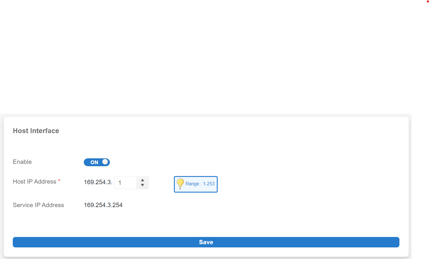

This is generally how the ASPEED BMC's (which supermicro, and almost everyone, use) communicate with the OS. Dell IDRAC, etc does the same thing (for example, dell requires it for the OS service module to communicate with IDRAC).
In the case of supermicro, for the H12/X12 series of boards, if you want to disable it, go into IPMI, go to configuration->bmc settings.
Choose the host interface tab, and disable it.
On the X11/H11, it should be pretty close to that too.
