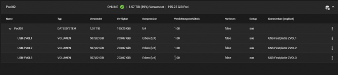

Hello everyone, I attached a USB hard drive under TrueNAS-SCALE-22.02-RC.2 and configured it as Pool02. See file: USB-disk-Pool02.png and USB-Disk-ST2000DL003-9VT166.odt. Well, this USB hard drive is not recognized by Windows and Linux operating systems, so there is no way to view the content. I am grateful for every hint.

TrueNAS uses ZFS. It's not designed to be a simple plug-n-play for Windows or Linux, as you are accustomed to with traditional storage and filesystems.
artlessknave
Oct 29, 2016
1,506
TrueNAS is a zfs storage appliance, not a standard OS.
TrueNAS can, or at least used to be able to to, read foreign filesystem such as windows and linux, but is setup to do so solely to ingest that data into a zfs pool. there is no GUI method for writing to such disks.
you can install zfs on linux, and it should be able to read such a disk.
you can install openzfs on windows, but thats alpha at best, and YMMV. i had to uninstall it because it seems like it was causing BSODs.
also, USB typically performs poorly with zfs, and is highly not recomended as a connection method for any drives, including boot drives.

Hello Winnilinnie and artlessknave. Very interesting to know this. I used this USB disk for security reasons to isolate important data from the network. Thanks very much!

With no contents on it... I'm not sure that's the OP's requirement... I think they were hoping to be able to read the files.
On Linux, install OpenZFS and import the pool.
On Windows, you may find it possible via the ZFS on Windows project (still in development stages, not really reliable). https://github.com/openzfsonwindows/ZFSin
