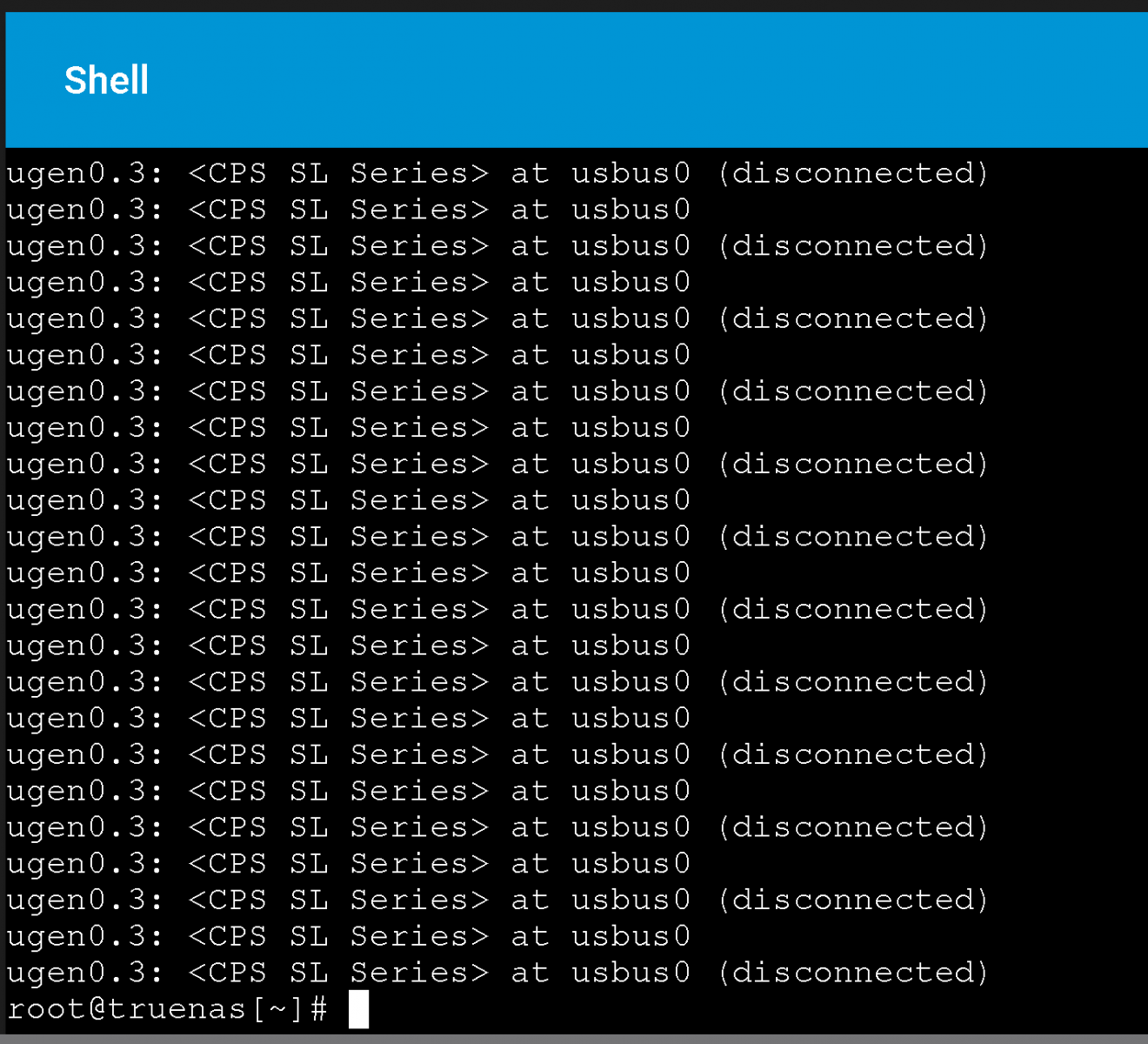

I am finding that Cyber Power UPS's (at least the new ones [Purchased 6/4/22]), aren't jiving with any of the Cyber Power Drivers currently included with 13. I'm using a Cyber Power -SL750U. I can find it on the USB Bus, (I've tried all ports/hosts. It attempt's to connect and then disconnects. I believe after some research, it would be an easier task to pick up a supported, APC, UPS. They seem to have the best compatibility. Any information or experiences would be greatly appreciated.

Oh goodie! :rolleyes: So this continues even with TrueNAS 13 (i.e, FreeBSD 13.x).
I've had the same issue with two different Cyber Power UPS'es from FreeNAS 11 through TrueNAS Core 12.0-U8.1, and it looks like it continues with 13.0-RELEASE. :frown:
My previous unit was the SX650U and my current one is the CP1500AVRLCD, which is supposed to work with NUT using the usbhid-ups driver.
The issue is random, unclear, and intermittent. I've tried all types of combinations:
  • Different USB cables
  • Different ports
  • Selecting a port manually in the options (or choosing "auto")
  • Stopping and starting the service multiple times
  • Unplugging and re-inserting the cable multiple times
  • Adding auxiliary options to the text field for upsd.conf, such as: MAXAGE 25
I've read online, from as far back as 2014 of others facing similar issues with a UPS + NUT (mostly FreeBSD or FreeNAS/TrueNAS).
But the units work, and they behave properly (such as safely shutting down the server upon losing line power) if the log isn't getting spammed with errors about communication issues or "stale data".
Sometimes a combination of stopping and starting the service, with a few unplugging and re-plugging seems to do the trick.
I was actually about to create a new topic about this issue until I saw your thread.
Oct 22, 2019
3,641
Try this combination and see if it helps:
For the driver, select usbhid-ups.
Under the auxiliary parameters for ups.conf:
pollinterval = 15
Under the auxiliary parameters for upsd.conf:
MAXAGE 25
Then restart the UPS service, and finally unplug and re-insert the cable. (Might have to restart the service again after re-inserting the cable.)
