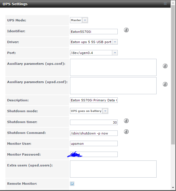

Right so i got the UPS and have set it up, seems to be alright except im getting some errors being chucked out by FreeNAS
UPS - Eaton 5S700i
Here is the error thats getting chugged out -

Here are the setting i have enabled -
Any ideas as to what this could be, cant be normal surely?
Thanks

EDIT - Tried changing the usb interface to ugen0.2 here is what i get -
Feb  1 20:08:14 freenas notifier: Starting nut_upslog.
Feb  1 20:12:01 freenas upsd[11156]: Data for UPS [Eaton5S700i] is stale - check driver
Feb  1 20:12:01 freenas ugen0.2: <EATON> at usbus0 (disconnected)
Feb  1 20:12:03 freenas ugen0.2: <EATON> at usbus0
Feb  1 20:12:05 freenas upsmon[11181]: Poll UPS [Eaton5S700i] failed - Data stale
Feb  1 20:12:05 freenas upsmon[11181]: Communications with UPS Eaton5S700i lost
Feb  1 20:12:06 freenas upsd[11156]: UPS [Eaton5S700i] data is no longer stale
Feb  1 20:12:10 freenas upsmon[11181]: Communications with UPS Eaton5S700i established
Feb  1 20:13:17 freenas ugen0.2: <EATON> at usbus0 (disconnected)
Feb  1 20:13:17 freenas upsd[11156]: Data for UPS [Eaton5S700i] is stale - check driver
Feb  1 20:13:18 freenas usb_alloc_device: set address 2 failed (USB_ERR_IOERROR, ignored)
Feb  1 20:13:18 freenas usbd_setup_device_desc: getting device descriptor at addr 2 failed, USB_ERR_IOERROR
Feb  1 20:13:18 freenas usbd_req_re_enumerate: addr=2, set address failed! (USB_ERR_IOERROR, ignored)
Feb  1 20:13:19 freenas usbd_req_re_enumerate: addr=2, set address failed! (USB_ERR_IOERROR, ignored)
Feb  1 20:13:19 freenas usbd_setup_device_desc: getting device descriptor at addr 2 failed, USB_ERR_IOERROR
Feb  1 20:13:20 freenas ugen0.2: <EATON> at usbus0
Feb  1 20:13:21 freenas upsmon[11181]: Poll UPS [Eaton5S700i] failed - Data stale
Feb  1 20:13:21 freenas upsmon[11181]: Communications with UPS Eaton5S700i lost
Feb  1 20:13:22 freenas ugen0.2: <EATON> at usbus0 (disconnected)
Feb  1 20:13:23 freenas ugen0.2: <EATON> at usbus0
Feb  1 20:13:26 freenas upsmon[11181]: Poll UPS [Eaton5S700i] failed - Data stale
Feb  1 20:13:26 freenas upsd[11156]: UPS [Eaton5S700i] data is no longer stale
Feb  1 20:13:31 freenas upsmon[11181]: Communications with UPS Eaton5S700i established
