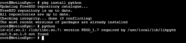

SOLVED Upgraded jail from 11.3->13. Python no longer working; /usr/local/lib/libpython3.9.so.1.0 not found

I know I know. Really late to the 13 part here on some of my jails but this one was working well for a long time and I was hesitant to touch it. So I created a clone and upgraded that so if I screw up I can always go back. So no worries on suggesting things to try.
That said. I'm running into a pretty critical error here in that I cannot get python to run at all. From some linux threads this seems to be a path issue but it's a little beyond me at the moment. If someone can point me in the right direction I'd really appreciate it.

Search the forums for FBSD_1.7, there are a few threads discussing this.
Is the jail 13.0 or 13.1?

What version of FreeBSD did you upgrade the jail to? The Python library is complaining /lib/libc.so.7 is missing API version FBSD_1.7.
I admit I searched for the missing lib file rather than this bit, but maybe I had a typo or something idk. I'll use this search term and see if that closes my issue.
The jail was upgraded to 13.0-RELEASE-p13 and the parent system is running TrueNAS-13.0-U3.1.
Based on a quick search from Volts' suggestion I'm going to upgrade the jail to 13.1 and see if that resolves. Thanks for the quick replies.

TrueNAS 13.0-U3.1 is actually running FreeBSD 13.1-RELEASE-p2. The latest jail RELEASE is 13.1-RELEASE-p2.
Well I definitely have some thoughts about that particular versioning practice. :tongue:
Upgrading to 13.1 resolved it and python is working. Now to solve the other litany of issues! Thanks for the help guys you can close this one.
