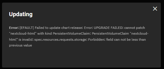

couldnt find anything via google, maybe some one can give me a hint what to change so I can update NC?
before it was complaining thc PVC simple needs to be changed to PVC and hostpath simple needs to be
changed to hostpath, so I changed both, restartet NC, it ran without any hickups,
then tried to update again and now its stuck and if I try to update it again, it shows this.

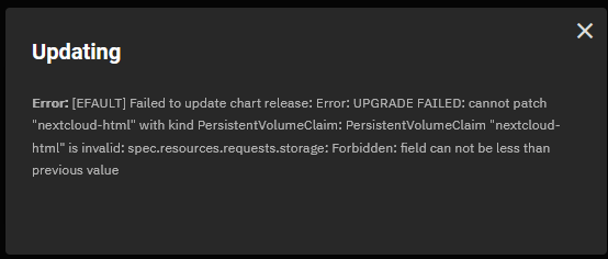

Thanks for the quick reply,
the error when trying to save the new settings stays the same:
