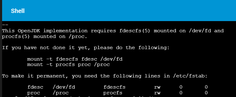

SO..tried
installation run smoothly
At the end I received this message :

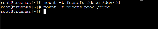

So I open another SSH and type both command wihout error
Now I try to open the webpage...but nothing
IP answer to a ping ...but no webpage on http://ip or https://ip or even https://ip:8443
Any help please ?
Thanks

First, from outside the jail, configure the jail to mount fdescfs and procfs:
  • iocage set mount_fdescfs=1 <name of your jail>
  • iocage set mount_procfs=1 <name of your jail>
Then restart the jail. The Unifi startup script should run when the jail starts.
This, of course, assumes you ran pkg inside the jail, and not from the host system.
