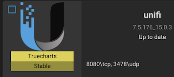

Hi, i've got exacly same problem with unifi-controller from community and cannot use right port...
I added truechart with unifi program and work witout problem!

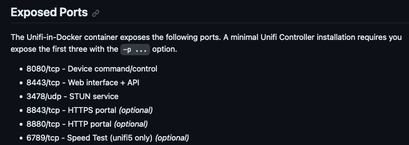

I'm sure OP has solved the problem already, but of posterity, the following ports have to be exposed (8080 and 3478)
The rest of the ports aren't required for adoption.

Last note, the ports above HAVE to be the ports shown there, sadly Unifi have decided those ports belong to them and changing them means you need manual intervention (ssh to the device to adopt). If you want to learn more, you can read https://help.ui.com/hc/en-us/articles/218506997-UniFi-Network-Required-Ports-Reference
If you have other apps running on those ports, I suggest using a reverse proxy and don't expose the ports, and if you absolutely HAVE to expose those ports on another application, you'll want to use something like MetalLB.

I am experiencing the same problem. The truenas version of unifi does not detect any of my devices, if I install the truecharts version it works flawlessly with no additional modifications. I wanted to move away from Truecharts but this is making me rethink doing so.

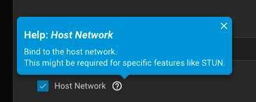

1. I did Option 43 in DHCP (done in my OPNsense appliance) using this link that was shared above: https://tcpip.wtf/en/unifi-l3-adoption-with-dhcp-option-43-on-pfsense-mikrotik-and-others.htm
2. I checked the Host Network box as shown in Hedin's post. (Thank you @Hedin)
This solved the port 3478 in the community app for me.

Just registrerad here to confirm that @Hedin Solution worked like a charm. Thank you.
It looks like you dont need to do option 43 on @requird post. just activate HOST.

Does anyone know what that checkbox, Host Network does? I can't find any documentation on it.
adi.li
Feb 9, 2024
From my understanding the apps are isolated with own virtual network and everything. When you activate host for the app it forces the app to show as part of the hosts ip (truenas) but on a different port. This means that the app will use the same ip as the host and will occupy the ports it needs. Ports that are now used from the app, in this case the unifi app will not be available for other apps or services. Correct me if i get this wrong.
