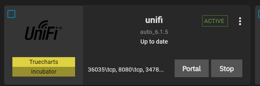

I know Unifi in the truecharts isn't part of the main chart so i just wanted to check to see if anyone had gotten it to deploy properly. and if not has anyone gotten it to load using a docker image.
guyp2k
Nov 16, 2020
26

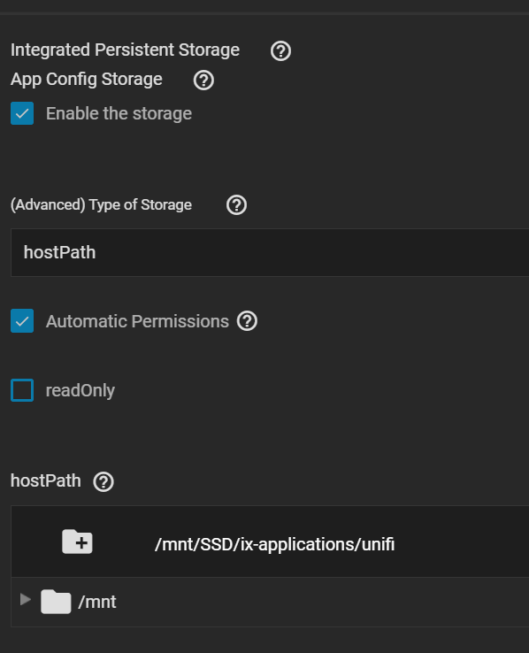

Deployed fine via Truecharts on 21.06.beta, imported config, and performed set inform on all switches and APs, no problem.
oumpa31
Apr 7, 2015
253
cool but i can't seem to get it to go active. did you use any special settings or just put the name for it and deploy it.

awesome thanks for the help. need to make dinner i'll be trying this later

@ornias I figured I'd ask here first because I seam to try to do too much with the initial setup which can cause issues I've found. lol. @guyp2k settings actually fixed the issue to get it loaded on my test server.

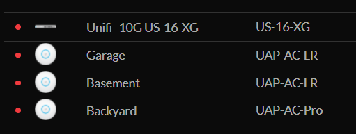

So i finally had time to work on this other than getting it loaded so i uploaded a backup of my settings and it says there's no connection to anything on my network. I run a pfsence box do i have to set some sort of port forwarding even though I'm local on my network.

Given this is a new instance of the Unifi Controller, you are going to have to adopt and provision those Unifi devices to the new controller. I just wrote a script that attaches to all my Unifi devices and set inform http://ip of new unifi controller......
It is a new instance but i used a backup to load up my existing setup.

Understand, but you still have to adopt and provision to the new controller via set-inform, at least I did.
oumpa31
Apr 7, 2015
253
You need to ssh into each device (or script) and login w/ same credentials as the controller and run the following command:
set-inform http://ip-of-host/new controller:8080/inform. Once you do that, you should see the unifi devices provisioning in the Unifi GUI.
This was exactly what I had to do. Thank you a ton. some of my access points are in very hard places to get to so resetting them manually would have been a pain.
