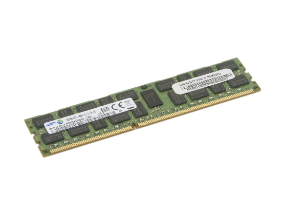

Does anyone know what the model numbers mean on Supermicro memory chips? Is there something I should look for as far as faster or newer or a series that I should stray away from?
MEM-DR316L-CL01-ER18
MEM-DR316L-CL02-ER18
MEM-DR316L-HL01-ER18
MEM-DR316L-HL02-ER18
MEM-DR316L-HL03-ER18
MEM-DR316L-SL02-ER18
MEM-DR316L-SL03-ER18
MEM-DR316L-SL04-ER18
MEM-DR316L-IL04-ER18
I can assume that SL04 is newer than SL02? but does any of that mean anything? They are all the same price.
I have a AsRock Rack EP2C602-2L+/D16 which takes 16 x DIMM DDR3 1866 / 1600 / 1333 / 1066 LR / Registered / ECC / UDIMM, max. 512GB. I plan on having 4 or 6 of the DDR3 1866 16G RDIMM sticks. The compatibility list only has a couple sticks listed on it which are very expensive, I don't assume there is a problem with getting memory not on the list as long as it fits the DDR3 1866 RDIMM requirement.

You pay a lot more for the faster memory and it doesn't make that much difference in performance because the slow part of the system is the drives.
I would suggest going with the 1600 LR DIMMs like these:
https://www.ebay.com/itm/Dell-Power...00R-ECC-Registered-Server-Memory/163167168154
PS. Just because it says it is for a Dell server doesn't change what kind of memory it is.
Thanks for the suggestion, all listed models are 39.99 on amazon or newegg and are new not used. 4 dollars cheaper, new not used, and faster. Assuming no one knows the difference in the model numbers I guess I will just get the SL04 because it is the biggest number!

They are lying to you about that, but even if it is 'new' that doesn't make it better.
Good reasoning, but wrong. That number has to do with "Cas Latency" of the memory module.
Have you ever heard of NEMIX as a brand name? I have, and it is not a good one. They are NOT an acutal Supermicro approved vendor. The picture doesn't even have a Supermicro part tag. They are just claiming compatibility to try and boost their sales. So you are picking a no-name knockoff because it claims compatibility with Supermicro when you don't even have a Supermicro system... Your decision making process is flawed.

This is the kind of memory Supermicro uses:
https://store.supermicro.com/memory/16gb-ddr3-1866-mem-dr316l-sl03-er18.html
