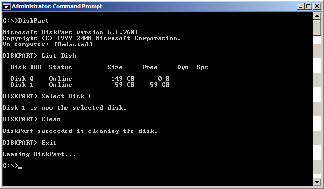

That drive seems funky... Is it the same make/model as the others? Might want to connect it to a Windows machine and use "DiskPart" (and then "Clean" command) to see if you can wipe it there. Just be careful with DiskPart since choosing the incorrect disk will lead to you wiping the wrong drive and loss of data...
For example here is me wiping a USB Stick (which is a 64GB PNY) on a Win 7 Machine:

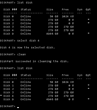

It's different in that the old disk failed and this is the replacement. I'm sure the part # isn't the same as the other three disks but it's still a 300GB 15k SAS drive. I cleaned it but that doesn't seem to have made a difference as I still get a 'Unable to GPT partition the disk' error when attempting to add it to a volume.

Got a few things for you to try in order to try an isolate the problem and a few questions as well...
1) You have never told us which version of FreeNAS you are using, so what is it?
2) Can you move the hard drive to another bay and try again?
3) Looks like you have four 300GB drives, two of which have zero free. Can you explain that?
4) Create a FreeBSD 10.3 VM and try that drive again. You already know other OS's seem to work, is it FreeNAS or FreeBSD?

5) See attached for the devices and their model #s:
