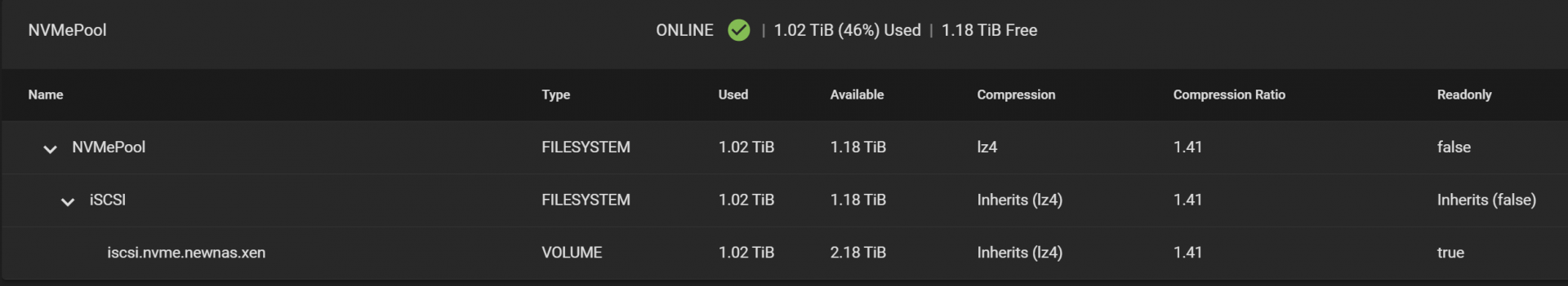

I have 4 Pools on my Scale Setup under 22.02.1 (I was on 22.02.2 but have since reverted due to boot issues)
However I have a Pool consisting of 4 * NVMe drives as a pair of striped mirrors. 2 * 2TB, 2 * 512GB. Its a test pool and has no real purpose at the moment.
I cannot delete it - every time I try its says that the pool is busy
root@NewNAS[~]# zpool status NVMePool pool: NVMePool state: ONLINE scan: scrub repaired 0B in 00:00:40 with 0 errors on Tue Jun 28 00:00:42 2022 config: NAME STATE READ WRITE CKSUM NVMePool ONLINE 0 0 0 mirror-0 ONLINE 0 0 0 2d70c99c-bbe0-4a49-909a-d0b66d7aaa34 ONLINE 0 0 0 073d3270-e1cf-4c00-8ed0-98c737274a2e ONLINE 0 0 0 mirror-1 ONLINE 0 0 0 42074efb-030d-4ed2-9258-06d689a2482b ONLINE 0 0 0 4ee3c8e5-da18-486a-a073-d835c13b9fce ONLINE 0 0 0 errors: No known data errors root@NewNAS[~]#
The Pool consists of a DataSet and a zvol
When I try to delete the zvol I get
[EBUSY] Failed to delete dataset: cannot destroy 'NVMePool/iSCSI/iscsi.nvme.newnas.xen': dataset is busy
If I try zfs destroy -r NVMePool I get
cannot destroy 'NVMePool/iSCSI': dataset already exists
It would appear that something is keeping the ZVOL open / working and thus preventing me from deleting the Pool
I could just remove and wipe the disks - but thats a ballache as it means taking the server out of the rack, removing a PCIe to NVMe Card, dismantling it and then wiping each disks seperately. And I can't do any of that till a restore completes
So I thought I would ask if anyone has any ideas?

It looks like you have an iSCSI share attached to that zvol. If you delete the share, you should be able to destroy the pool.
If there's no iSCSI share, also check if your System Dataset is on that pool.
