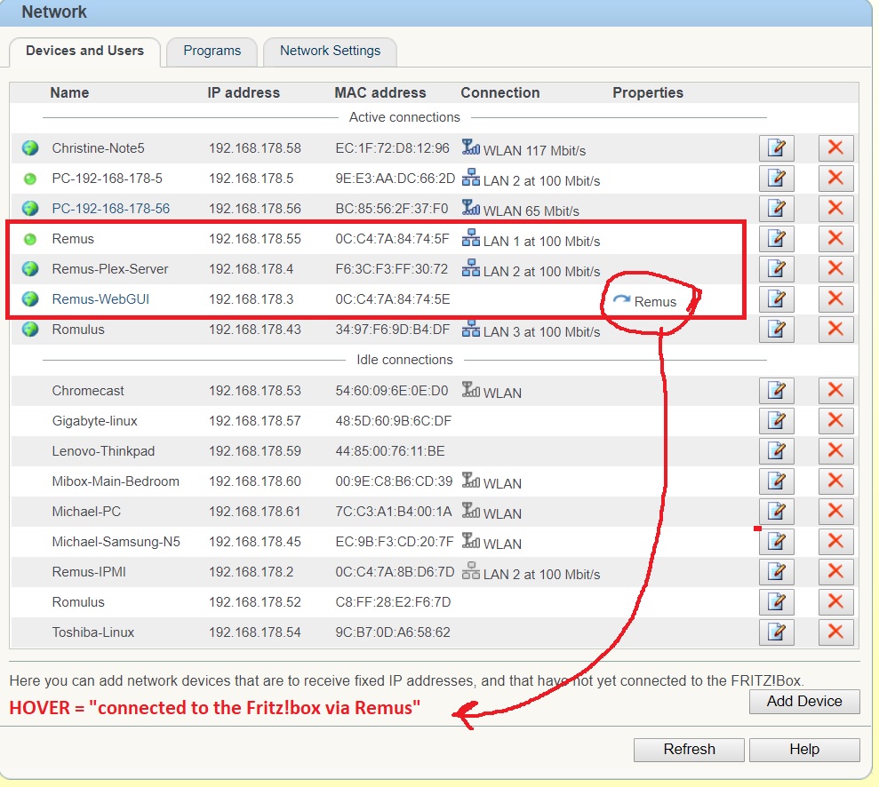

So while it's working, I still wouldn't mind some interpretation please as to what this all means....
(see attached) the IP ... .3 gets me to the GUI but it shows Remus (the machine which FreeNAS is on) at IP ... .55
15,504
root@Remus:~ # cli cli: Command not found.
No idea what any of that is about because it appears to be configuration inside your router and not a part of FreeNAS.
Don't use your router to set your FreeNAS IP address. Set it statically inside the FreeNAS user interface so you don't have to worry that a reboot of the router will assign a different address or leave you, even for a moment, with no address.

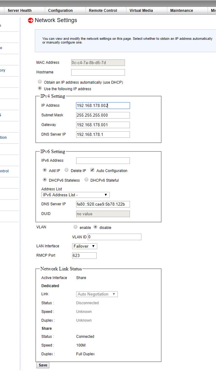

I appear to have properly set up the IP via the FreeNAS GUI.
Q: Should my IPMI be set up in the same way?
(I want it to be 192.168.178.2)
I asked because I tried, and using the same netmask but igb1 (rather than igb0 which is the netgui). It told me The network 192.168.178.0/24 is already in use by another NIC
Appreciate a little additional guidance... I am learning heaps. :)
EDIT: Further to the above I went in to the supermicro network settings menu and it seems to be assigned in there as per the attachment. Is that the correct way of doing things?
15,504
That is a correct way to do it. Another correct way is through the BIOS, and a third correct way is the FreeNAS web GUI at Network -> IPMI.
