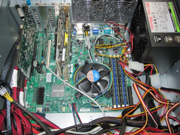

Gut the case, install a SuperMicro JBOD board like the CSE-PTJBOD series, and run SAS cables to an external SFF-8087 to SFF-8088 bracket. Presto, tower style DAS.

You'd only want to remove the motherboard/CPU setup from your existing tower; anything related to power distribution or backplanes should be left intact.
There's minimal logic to the JBOD boards - basically just able to handle ATX power-on, provide power to a few fans, and the newest models have IPMI for out of band management.
Hotswap capable cases will work better, as they're likely to use SAS signalling all the way through the system (which has better tolerance for longer cable runs) - if your current T320 has individual ports for each drive (or they're expected to be wired in directly) then your last leg from the external-to-internal SAS bracket would need to be a forward breakout cable as well.
PERC H810 is fine, just needs to be flashed into an LSI 9200-8e.
Patrick from ServeTheHome has a two-part writeup on building a DIY JBOD using one of these boards.
