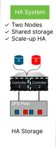

The HA version of TrueNAS SCALE is available on TrueNAS M-Series appliances.
It's quite complicated and very difficult to make it reliable and manageable without consistent hardware.

For users that want to use their own hardware, we recommend clustering. It's less dependent on hardware. We don't offer HA as a software-only capability since we'd then be on the hook for supporting it..
