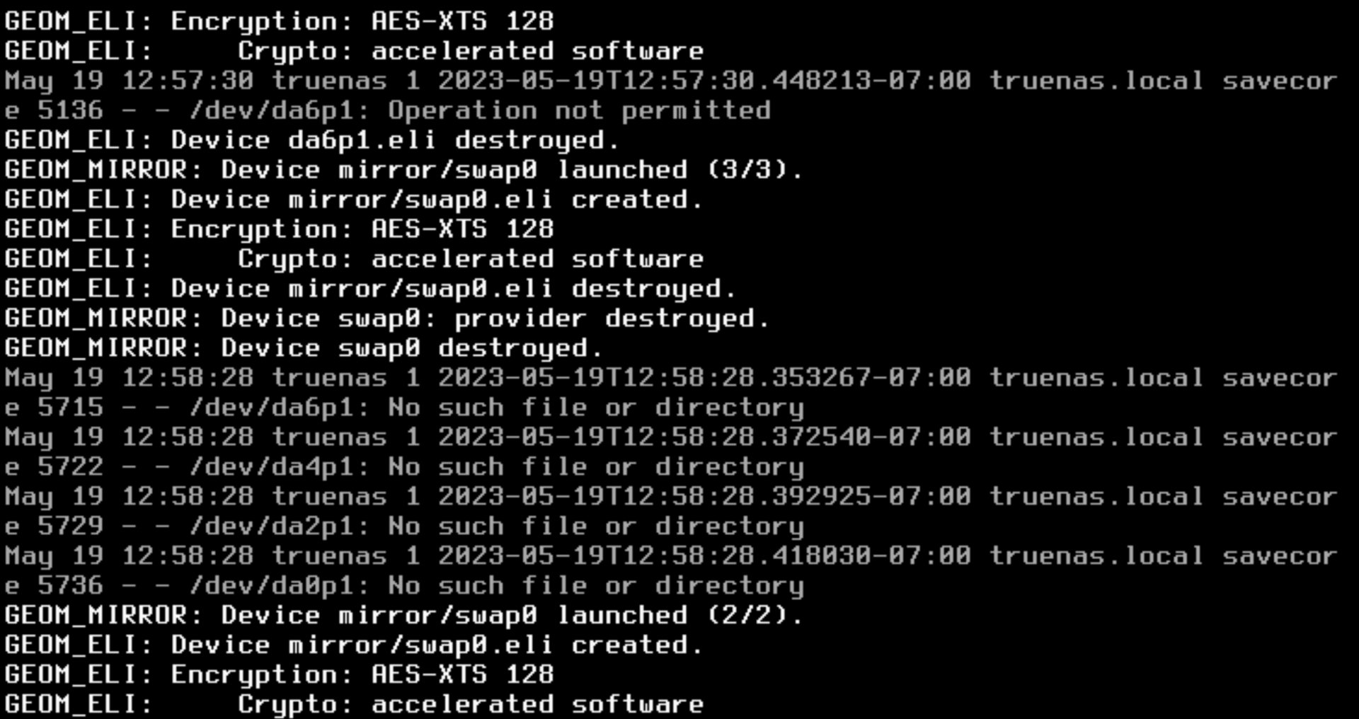

I have 8 of this dual actuator drive and created a pool just now and then delete it. its a fresh install TruenasCore, initially all disk is showing SO I got /dev/da0, da1, da2,da3,da4,da5,da6 and so on and I used even number for the pool that I created da0, da2, da4 and da6 after deleting the pool all even numbers on the disk list is gone and no longer showing up on the GUI only showing odd number disk like /dev/da1,da3,da5 and so on.
You sure about that? Duplicated serial numbers cause problems when they are attached to /different/ spindles, such as via USB adapters. In theory, a dual actuator drive should be exposing the same spindles, similar to the way a dual path SAS drive exposes two pathways to the same spindles. I'm just not sure if there are other differences.
Well, they're exposing different LUNs with different data, so it's not the multipath case. Like 10 TB on each LUN, controlled independently in lieu of handling that in the drive's controller (which is not really a bad thing, but it is different from the past few decades of disks).

This is the type of situation where you probably need to create a feature request in Jira if you are looking for official support. You likely will be able to create the pool by the CLI though, And I think it goes without saying but you are in untreaded waters.
