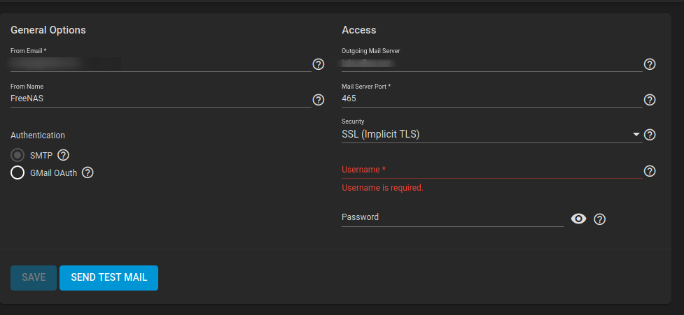

Why wouldn't an empty username and password not be ok !? i've been using host based authentication on FreeNAS and pfsense and so forth for decades. Ofcourse the mail server is hosted on a private vlan. And isn't public !?

Because the username that TrueNAS uses is root. This is for e-mail authentication, which the OP is correct, should absolutely be optional.
Many mail architectures do not even have infrastructure available to provide authentication of this sort. Usernames and passwords are generally only implemented on systems that *receive* e-mail, so that users can log in and retrieve them. In most cases, e-mail designs treat mail from servers as MTA (transmission) e-mail rather than MSA (submission) e-mail, and only MSA allows for user/pass authentication.
The reason you might use MSA is if you are not running your own mail servers (which you should be), and are instead relying on someone like Google or Yahoo! to run your mail, in which case FreeNAS needs to act as an MSA to reliably receive the mail.

It's not because it's a lot of trouble that you should. Not creating the account password and username is less work and that should just be an option. While it isn't.
And I don't want to send emails through gmail. I prefer not to use so much google. Why even run a NAS at all just buy cloud storage on google. It's almost as expensive as running your own NAS.
I don't understand your reasoning, .. the why isn't important when it should, it's not about it being a big deal, it's just something that's overall supported. Actually it makes more sense to support no auth mail then it does to support gmail, no auth mail is a standard while gmail is none of that.
Why does TrueNAS support gmail at all !?

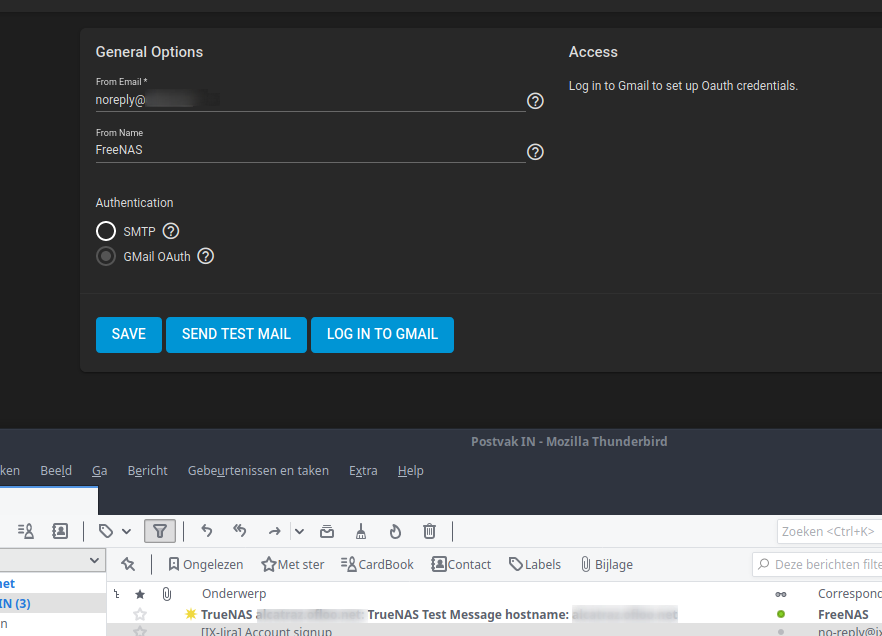

I upgraded from FreeNAS and funny enough when I send a test mail it still works.

Good day all,
I've discovered that you can still setup to send via your own internal mail server. It feels like a bit of a kludge but the steps below worked for me.
1) First fill it out the form with setting as SMTP and Security as Plain
2) Just put anything in the Username and Password fields to allow you to hit Save.
3) Hit the Save button and leave the form.
3) Then go back in and only change it to GMail OAuth and hit save - DO NOT click the Log In To Gmail button.
If you go to the command shell, you can also check the mail setup directly in the configuration database with the commands below.
root@freenas[~]# sqlite3 /data/freenas-v1.db ".schema system_email"
root@freenas[~]# sqlite3 /data/freenas-v1.db "select * from system_email;"
If you're really fussy, you could also update the table to clear out the gmail em_oauth field with command below (note the value being set is just 2 empty single quotes).
root@freenas[~]# sqlite3 /data/freenas-v1.db "update system_email set em_oauth='';"
Hope it helps some.

The option to disable Auth I think I saw was in Truenas 12.0-u2 because I didn't have any issue setting up in U2 but had to roll back to U1 for AD integration. Thank you Colby, your steps worked.

FYI, if you want to disable SMTP Auth in 12.0-U1, run this command: sqlite3 /data/freenas-v1.db 'update system_email set em_smtp=0, em_user=null, em_pass=null;'
