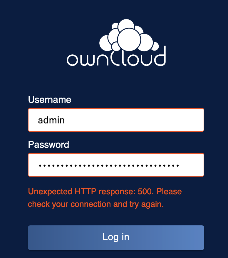

Tried that password but keep getting these errors:

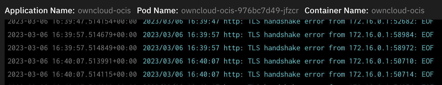

Also in the logs:
