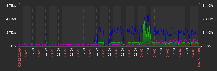

I use Zabbix to monitor disk activity on our primary systems and have noticed that since moving to Scale, disk activity on one of our nodes which is a replication source to the target wherein the target is the one performing the "pull" method of a Replication via SSH. Before Scale, Replication would take a couple of hours overnight and would be done in a very short order but now it appears to be taking so long, it's tripping over into the next days daily replication.
Here are the metrics:
(it says TB/s but it's actually GB/s, something is up with scale)
I can't see anything obvious and I have the same replication configuration as before, here are details and notes:

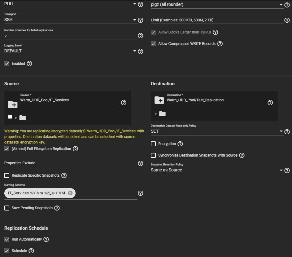

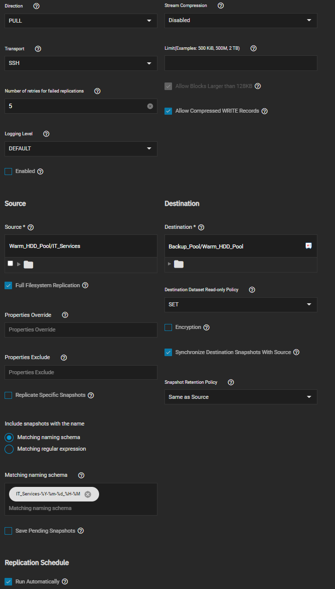

Below are the configurations to see if one works and one doesn't.
Scale Config:
Core Config:
I should hopefully have an answer for you soon as to whether it works or not or suffers the same issue. One thing I did notice before I purged the Scale node dataset is that it had snapshots but when i unlocked the dataset it had no children and the dataset was set to read only where it used to be set to "inherit (off)" which I found very odd.
