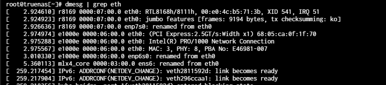

then when it tries to continue to boot it fails on config import or something. even if it boots it fails to obtain Ip. I've put the same mellanox 10g sfp+ nic as previously. looks that naming has changed but wieh o connected directly and select 1. - for network configuration there is nothing.
but mlx4 driver is working

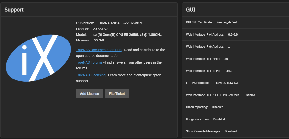

I've tried to do a fresh install on another ssd and seems that i was able to access truenas on x99 after some tinkering with ifconfig. after i accessed gui i've imported config seems like it was working.. but dashboard was completely empty

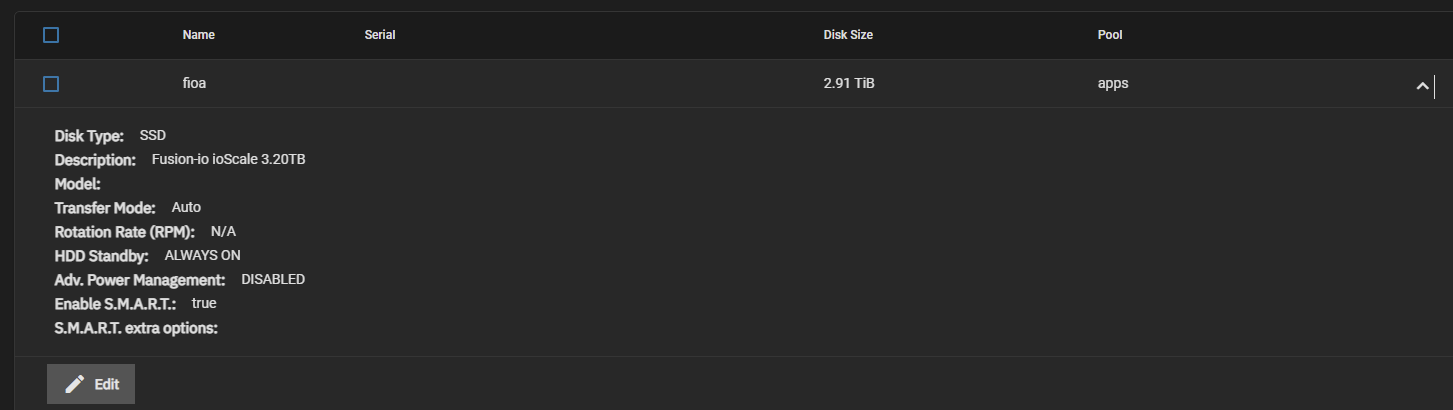

even though fusionIO was visibe zfs pool of that disk wasn't attached. when i was trying to import it there wasn't anything to import.

then i've put fusionio
it was recognizer properly and zpool has been attached.

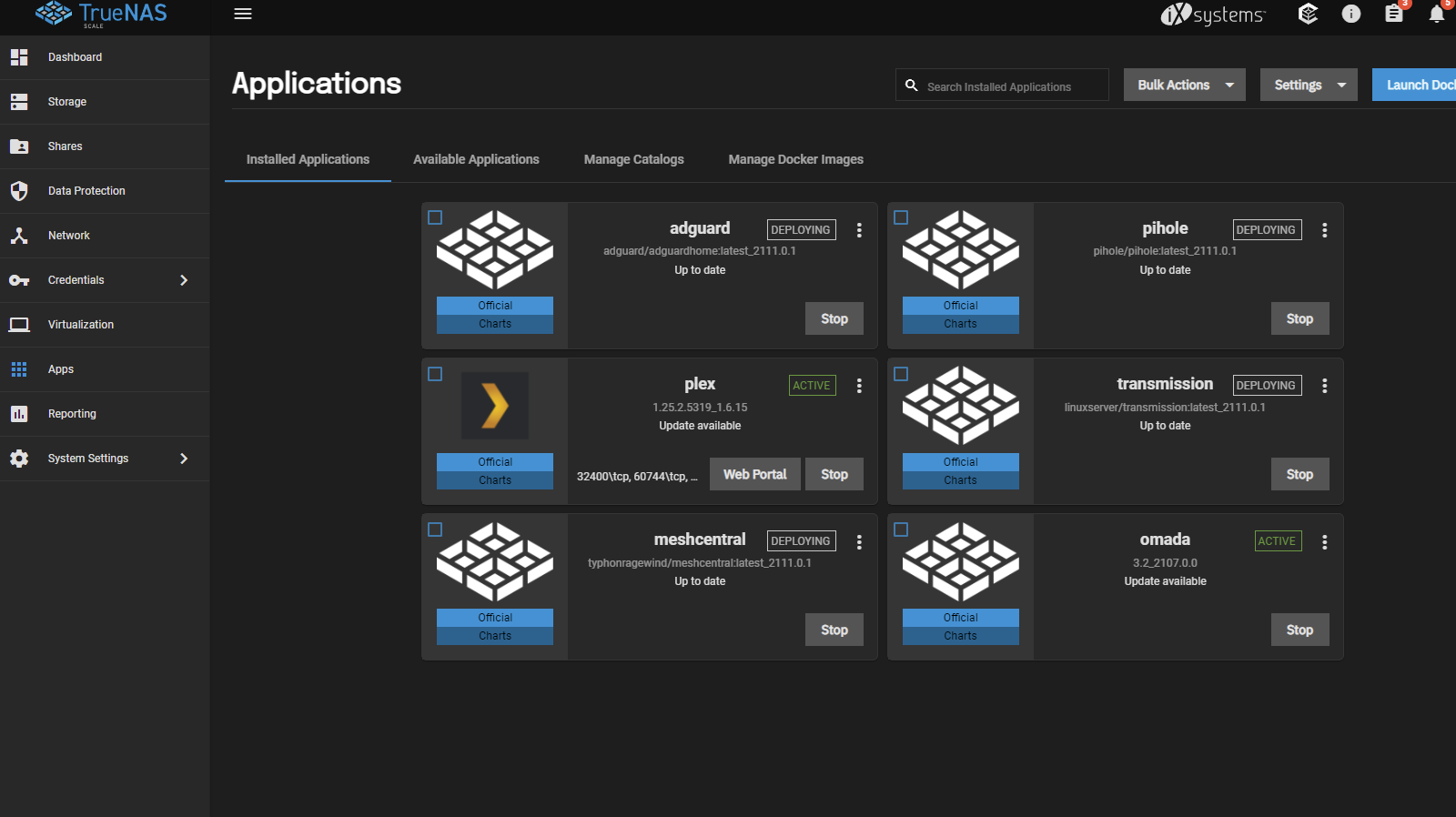

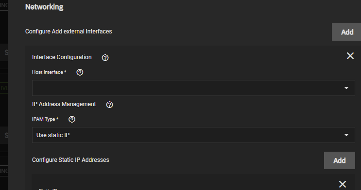

I had to reconfigure k3c network to make apps visible

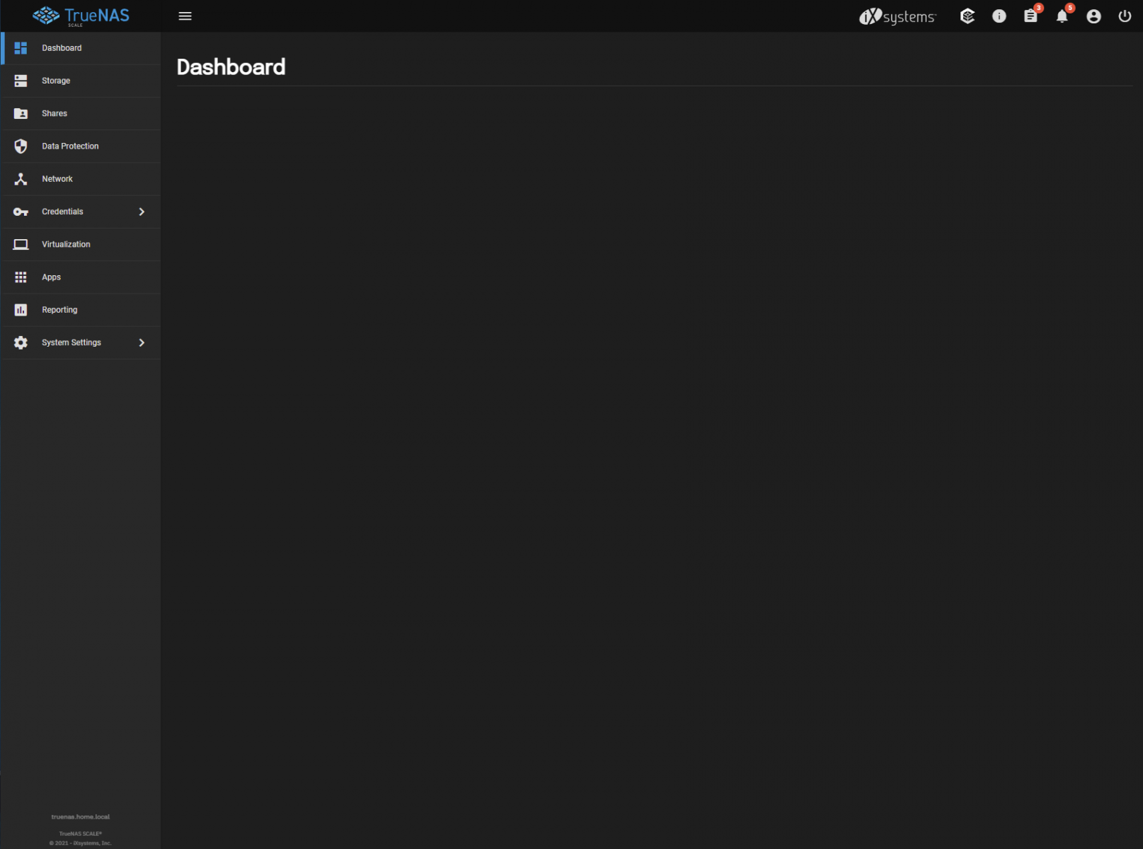

my only issue as of right now is that dashboard is empty
i also don't see another nic connected. only mellanox that i've plug from old server
there is integrated realtek nic and i've put intel ct nic pcie 1x

i see that intel nic

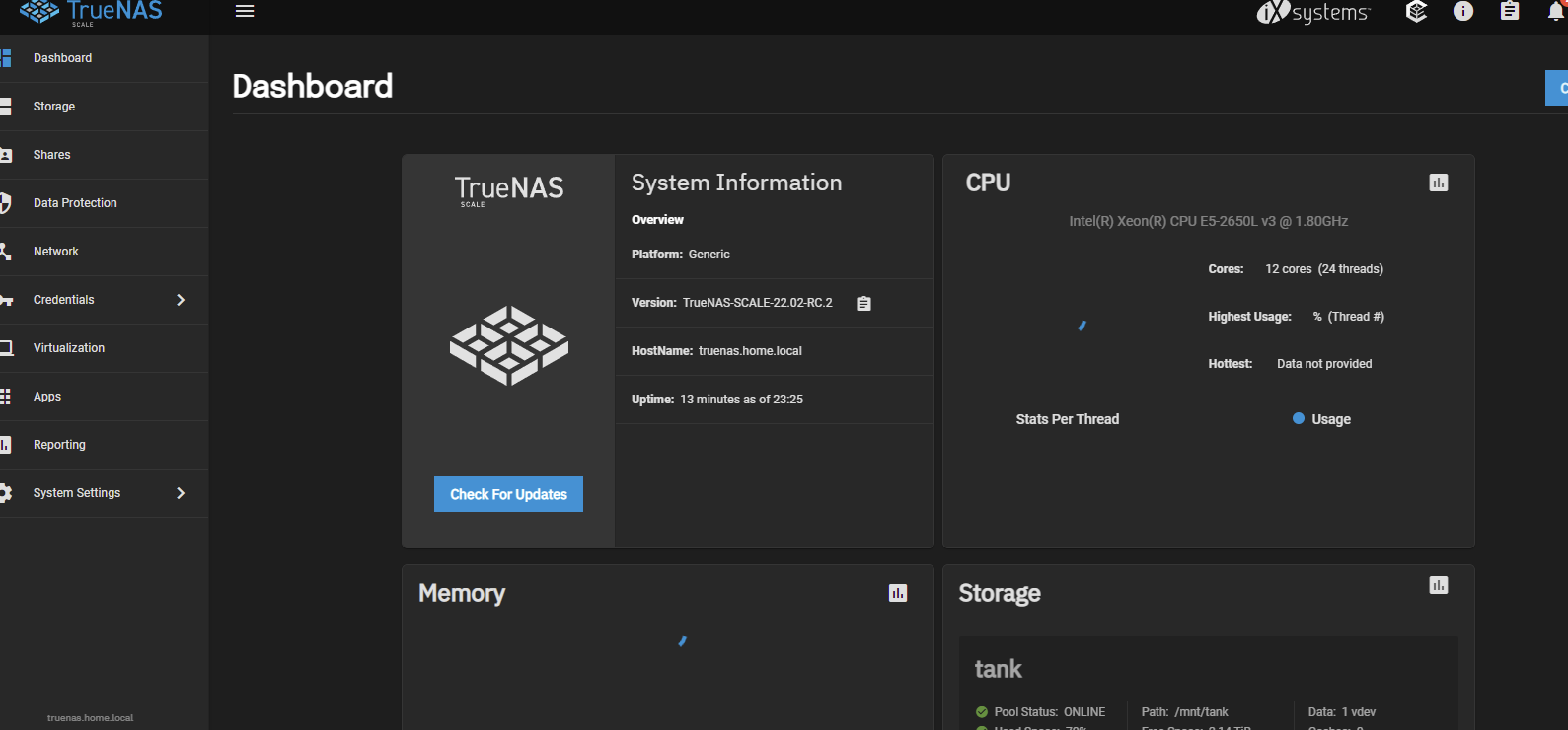

Oh i had to recreate vlan to enable that nic
update2
after i've recreated blan and connected second nic dashboard is back
