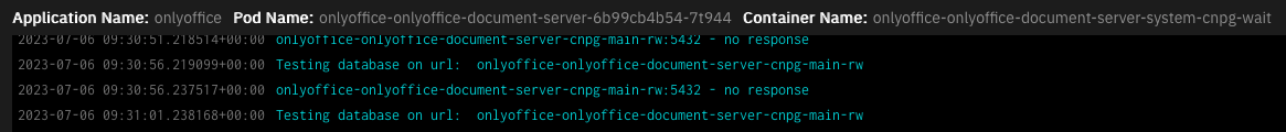

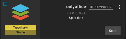

As of this post we are on TrueCharts OnlyOffice 7.4.0_10.0.24 and Scale 22.12.3.1. It gets stuck in deployment.
The onlyoffice-redis container appears to start up successfully. The only other container that starts at all is onlyoffice-onlyoffice-document-server-system-cnpg-wait which cannot seem to connect to whatever it wants to connect to:
From there it is hung:
Has anyone been able to deploy OnlyOffice?

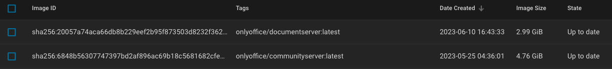

Thanks for the tip. I pulled onlyoffice/documentserver and tried again with the same results. Do you mind sharing your settings?

Is this what you ended up with after pulling the images?
