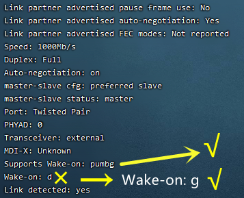

Truenas SCALE 21.06-beta1 can't wakeup on lan.
What's wrong
The network card light does not light up after shutdown。
There was no such problem before
I used another version before
truenas CORE 12

Thank you for your attention to my problem and I am very glad to receive your reply. I don't know anything about APIs. I didn't do anything about Trenas core before. This wake command can also be issued through my Huawei router, which can be operated on my mobile phone. In addition, I can have the BIOS periodically wake up Truenas Core, but these methods fail on the SCALE
How were you doing it previously?
The recommended approach is to use the APIs... have you checked those?
tianyaxun
Feb 12, 2021
15
when CORE and Deepin OS is shutdown, the net card indicator light is on, and when SCALE is shutdown, the card light is off.

The problem has been solved
