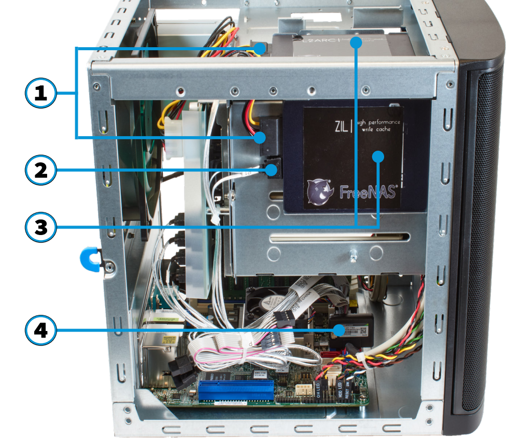

I opened the nas but couldn't find the flash drive, so I guess it's integrated in the motherboard.
What can I do ? The flash drive is visible in the bios, but won't boot. No error message beside the one mentionned.

Item 4 is your SATADOM boot drive (plugged into a SATA port). I beleive that there's likely a power cable connected to it also.
Is the flash drive showing as the first device in the boot order? From your note above I can't tell if you checked that.
If this were my machine I would delete any another drives listed in the boot order as you don't want it to try any of the data drives (which will produe the error messsage you report).
You say you disabled all the other drives - by disconnecting them, or how?

Yes, I have this item 4 ! I suspected it was the flash drive, but wasn't sure. It shows in the bios.
I removed all the others drives from the bootup options. I will try to unplug all the drive physically.

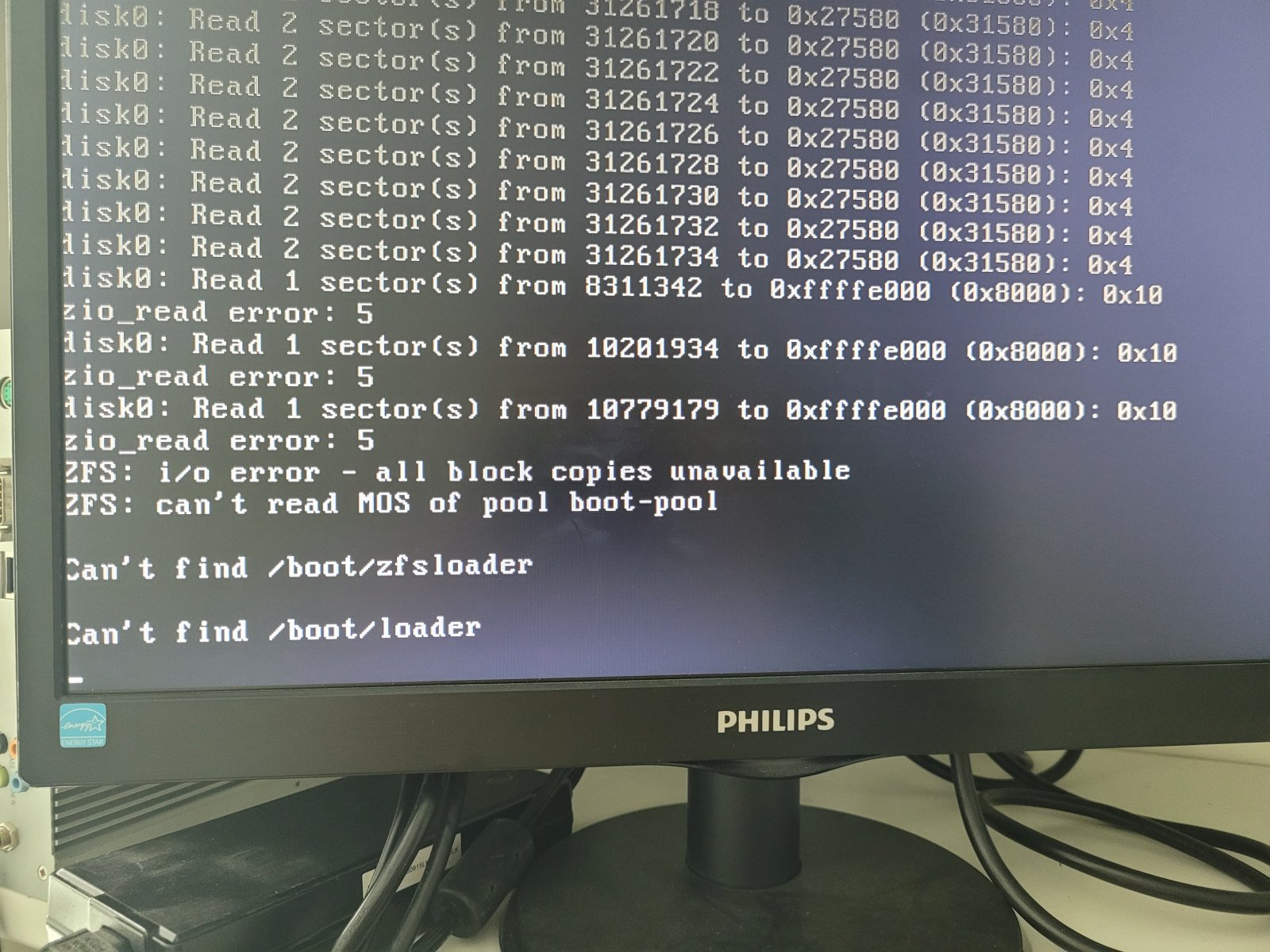

After unpluging the pool drives and plugging in and out the flash drive from the sata port, it was detected and "booted" to crash. I think it's fried, see below
Any suggestion ?

It doesn't look good for the SATADOM, but I would try a new install to it, if only for the learning experience.
While that's goig on, find the best quality USB key you have on hand and be ready to make a fresh install on that to get your NAS up and running. Or, better, a USB SSD. Or a SATA SSD, or new SATADOM, whatever takes your fancy.
Come back when you are up and running and we'll look into trying to find a configuration backup.
