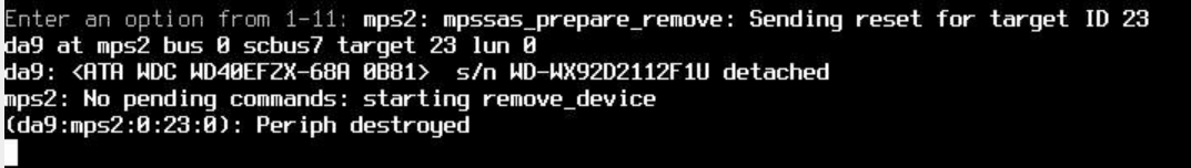

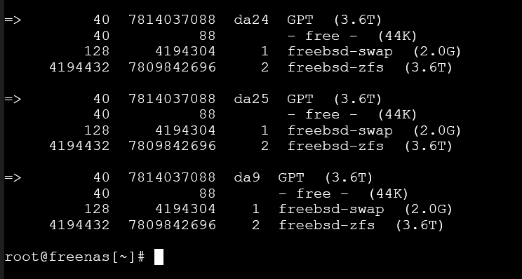

Good afternoon. There is a strange situation.
The disk in the pool shows UNAVAIL, but the system sees it, formats it, the table is marked up, everything is fine. But in the UNAVAIL pool. I checked the cables, swapped them, even installed a spare controller.
It is visible in the system.
It shows outside the system
Please tell me how to find out the gptid of the old disk if it is not already in the system. Thanks
Patrick M. Hausen
Nov 25, 2013
7,776
It should show in zpool status output. The other command that shows you the IDs even for disks that are not part of a pool is gpart list. Look for the partition of type freebsd-zfs and the rawuuid field.
