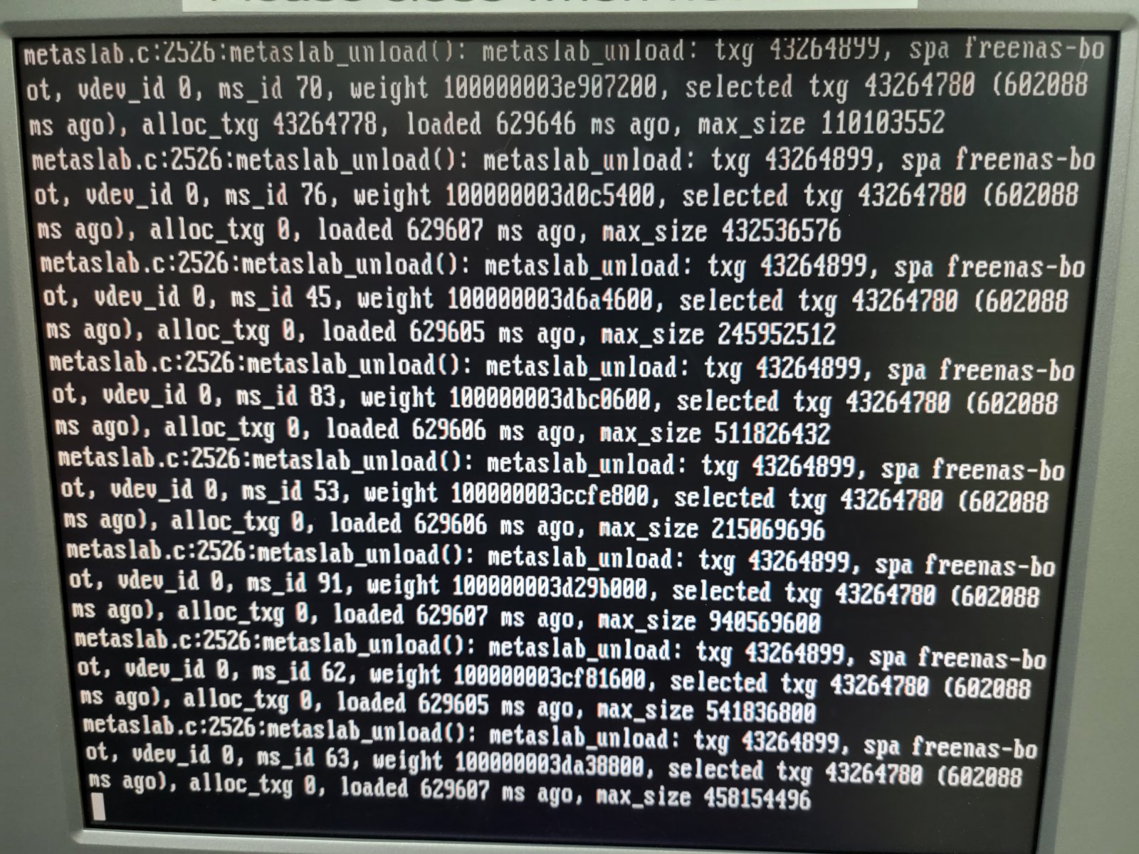

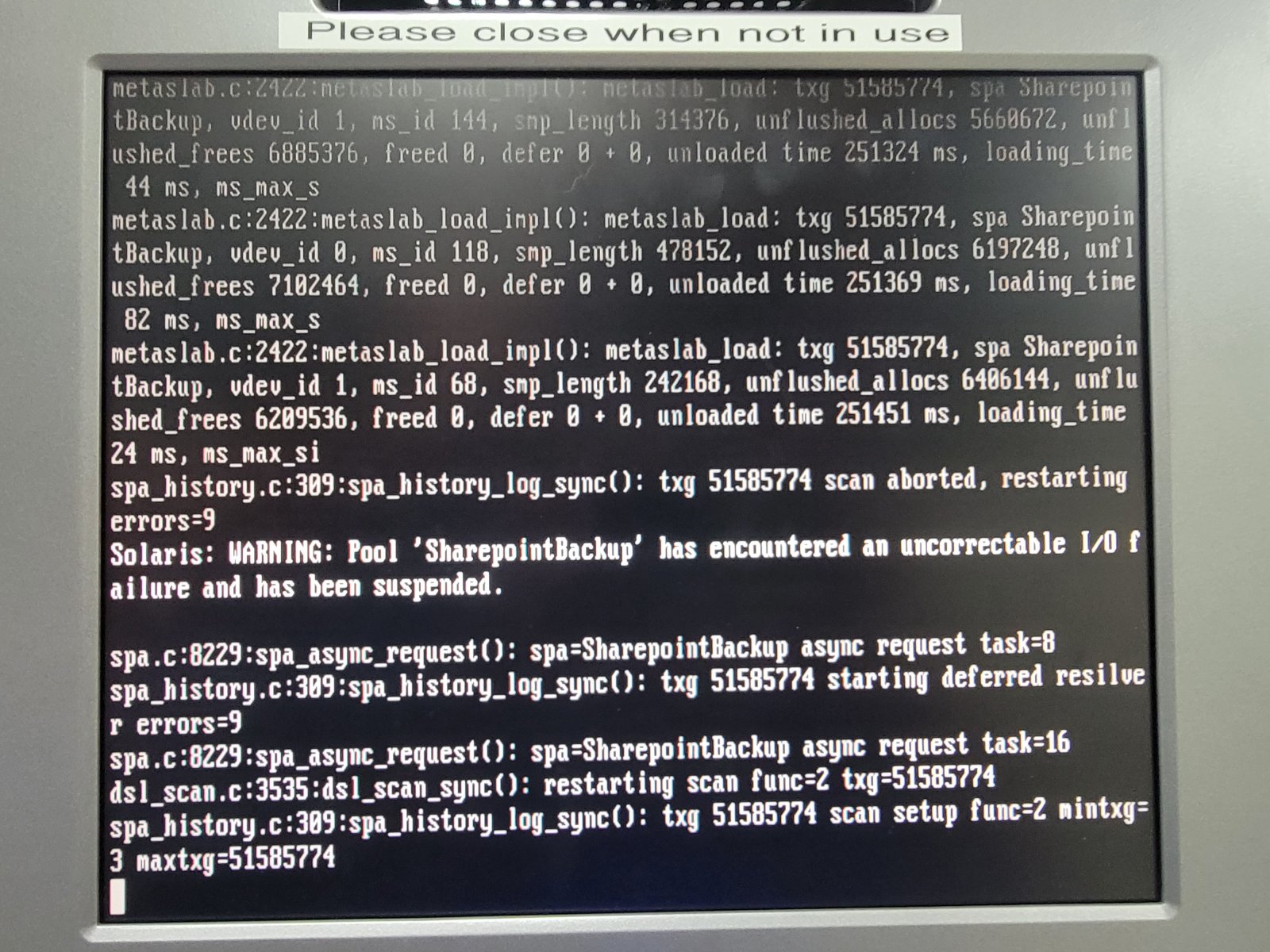

During the night, my TrueNas had a issue and was no longer responding, or even on the network (wouldn't respond to ping)
Did a power cycle, and still doesn't come up to the point of even getting back on the network.
I have included a couple of images in hopes somebody might know what to do.
The pool named "Sharepoint backup" did have a failed drive yesterday, and it was in process of re-silvering. I do not know if it completed before it had a stroke.
Any ideas on what I can do? I am by no means an expert, so if anybody has any ideas....explain them like I know nothing. ;)

Are those messages that it prints out during boot or before you rebooted?
JohnFLi
Sep 26, 2016
139
Those are during reboot. The screenshot that ends with 4496...that is where it stops. been sitting at that screen for about 2.5 hrs.
if I could get it to where it skips, or even drops the storage pool named 'Sharepoint Backup', that would be fine. ANy data I want is in a different pool

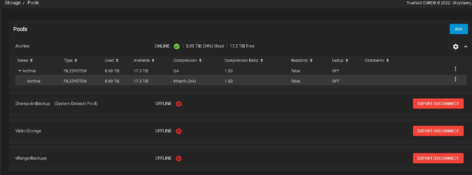

Made some progress!!
Ok, so after getting back into the interface, and after loading old config, and getting back in teh system.....

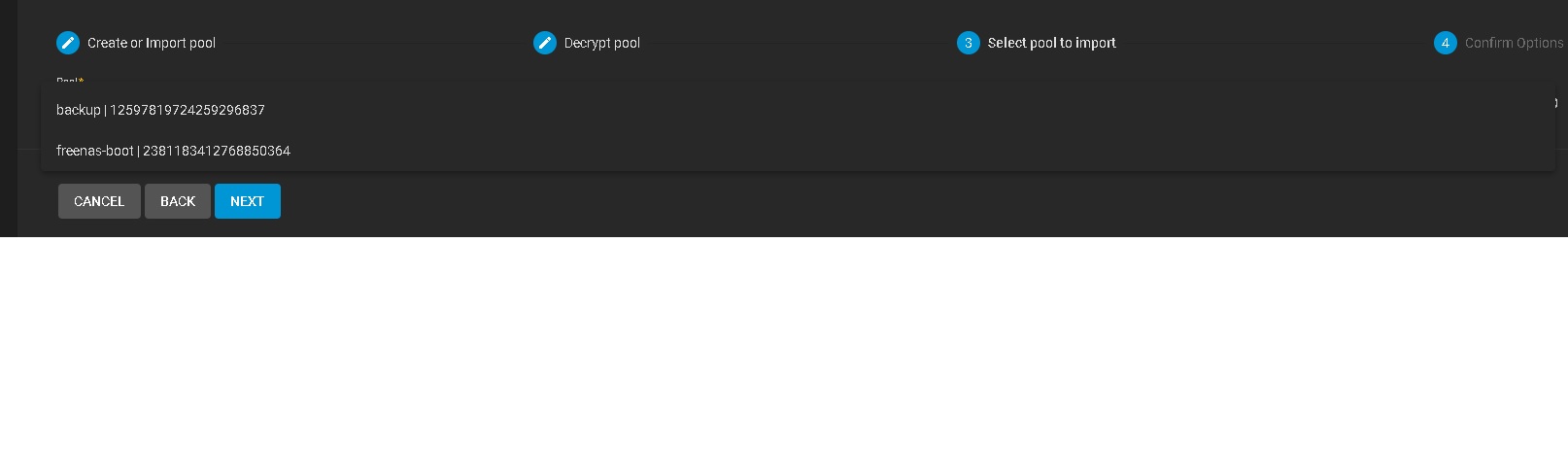

I go to storage Pools, (of cource nothing is there, but I was able to import 1)
Out of what I sees, I would really like to get the VideoStorage back.....even for a few hours, but when I try to import that one, I don't see the option
I go through the process for teh storage pool....I click Add, I select "import from existing pool"
After it does is searching, it come back with somethign different
It sees teh pool I want when going to 'storage pools', put doesn't see it when I try to import.
Any ideas?
One thing I have also noticed.... WHen I go to 'Storage' then 'disks' it is only showing 17 disks..... I have about 40 or so disks.....which I would guess might explain why i can't import the pool....
