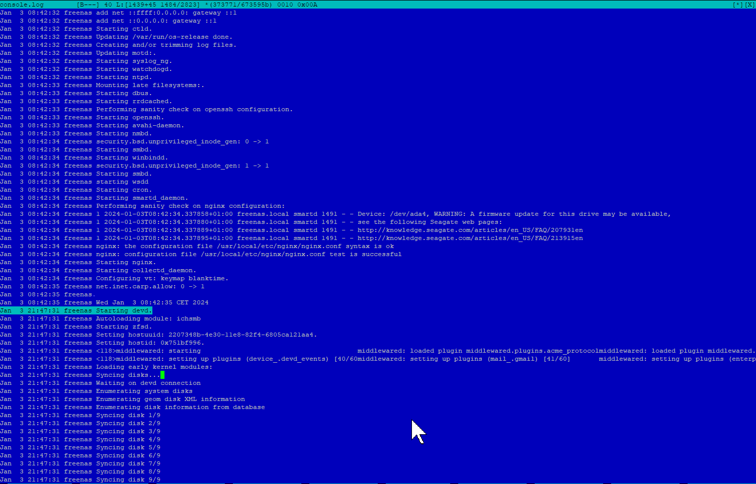

Result of this behaviour can look like this:
boot time Thu Jan 4 09:23
boot time Wed Jan 3 21:47
boot time Wed Jan 3 08:42
shutdown time Wed Jan 3 08:40
boot time Wed Jan 3 08:34
boot time Tue Jan 2 21:28
boot time Mon Jan 1 21:55
boot time Sat Dec 30 21:16
shutdown time Wed Dec 27 21:43
Console.log around the timestamp of an unexpected reboot:
Daemon.log
Messages.log
If anyone has any ideas, i'm quite curious to find out what i'm missing!
Kind regards
Rik

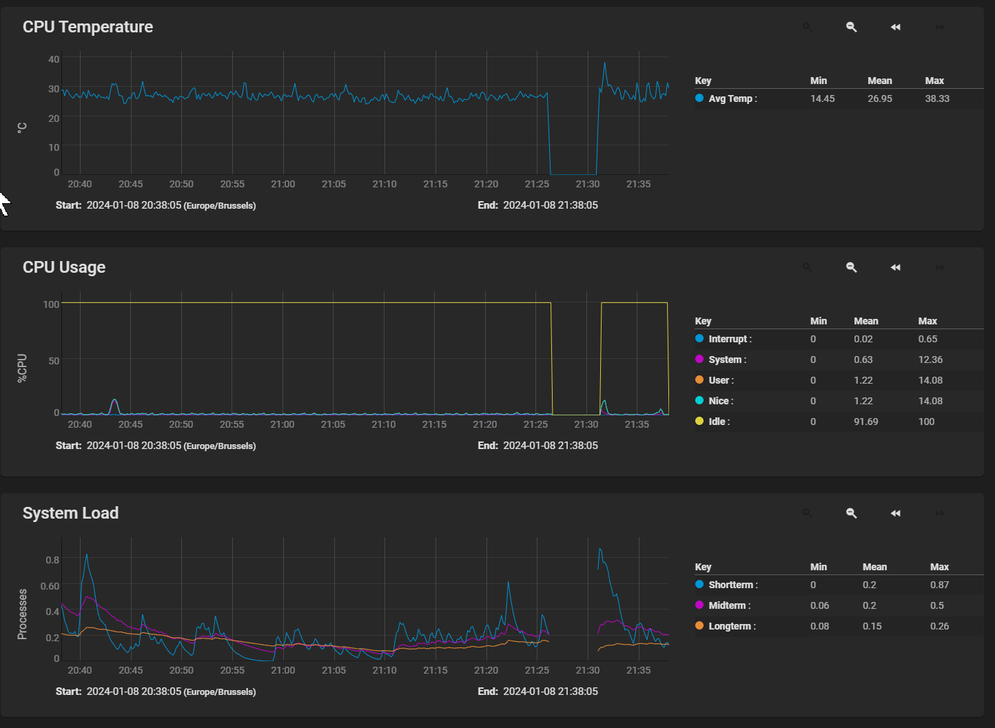

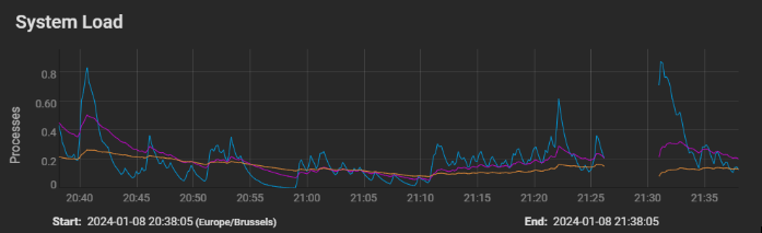

Just happened again at about 21h27, so far for hoping it was related to cabling...
we were about 1 hour into a movie being streamed, no other load.
I have highlighted the line where it's being powered on again.

Jun 15, 2022
674
This could be anything as obtuse as the CPU paste dried out, CPU overheats under load and bork....
Patrick M. Hausen
Nov 25, 2013
7,776
Jun 15, 2022
674
That would have come up in my cpu load test? I had it running at max cpu load for 40 minutes.
cpu load when i'm using it is <10%
Well, that's the thing, it's hard to say; your CPU could be heating up, flexing the mainboard, that bends the CPU just wrong, bork. Though I'd lean more toward memory corruption at that point which is sometimes fixed by re-seating the RAM modules. Years ago I had a CPU that was "over-used" and had electron tunneling, which is an odd thing to diagnose and test for, but it was, and it did odd things...none of which looked like CPU issues (maybe RAM, but not CPU).
Anyway, I'm not saying it's a CPU in your case, rather you've an unusual issue and some system stress testing for a week or so ought to cause it to show up. Re-seating everything is a good start, but the bottom line is your data is possibly at risk, so you might want to ensure your 3-2-1 backup plan works great, then stress-test the whole system at once until the problem can be triggered consistently, then narrow down testing to smaller parts of your system until the source of the problem is located. In an unusual case I've had a drive controller take down the system, power overload issues can do it, tiny shorts can trigger an emergency shutdown in a good power supply (so your system isn't smoked)--on that I had one server power supply system that would output insane amps per PSU yet trip on the smallest short (by design), which is in theory super-safe UNTIL a server went up in flames in front of me--behind my back, actually, but I heard it pop and turned around to see orange flames inside the case and shortly thereafter smoke poured from the unit--anyway, that's all to say I don't trust flaky systems, take the data off them and figure the best way to diagnose the problem before touching anything physically--because I want to find and remove the problem.

Difficult. Do you have a console monitor connected and also happen to own a dashcam or something similar?
Installed the nas in the livingroom with a camera pointing at the screen this evening, it just plain powered off, no errors on display
