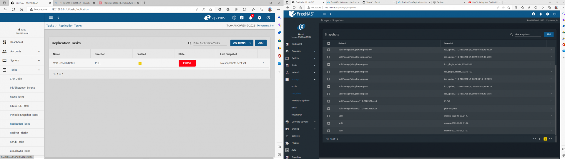

Here are my notes about troubles I had with replication. I finally got it to work. I posted this so that others with similar issues might get to the end quicker. I set out use replication between FreeNAS-11.3-U4 and TrueNAS Core 13.0-U1.1. The FreeNAS is nearly full and I want to move the data over
using Replication. I could not get the FreeNAS to TrueNAS push to work so I tried a pull from the FREENAS box using the new TrueNAS box. I created the Snapshot of Dataset Vol1 on the Vol1 pool on FreeNAS then went to replication tasks on TrueNAS box. I was able to connect with the SSH and navigated to the "on a different system" to Vol1 pool. I selected the "on this system" for the Pool1/Data1 destination. I then ran the replication task. It does warn me that "0 snapshots found" on the source side of the GUI, I confirmed there is one on the FreeNAS system of Vol1. Even though I created one on the Freenas box. When I run the replication task I get an error that the snapshot cannot be found.
Then I realized that the filter field in finding the snapshot is always on. The default is "auto" so my "manual" snapshots were not seen. I fixed that. Now I get an error that says my target is busy. I had some things in the directory it complained that it would not overwrite them, so I deleted the couple of files. I did not understand what busy was? After some more work I found that busy is because I have a running Plex server in a Jail that is attached to that volume. Shutdown the Jail and viola the replication is happening. I hope this post helps someone. It is running a peak of 2GB/sec over my 10Gb link. Fixing that's for another day.
So replicate the directory before you give plex access to it.
Update: Data is now replicated on my Truenas server with Plex Plugin and I am streaming movies!
