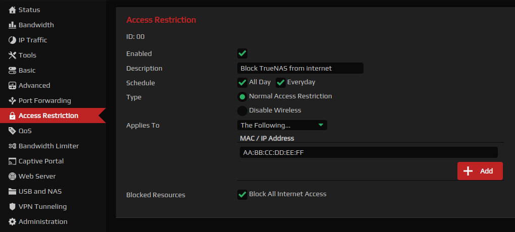

You can do this with FreshTomato or DD-WRT on your Nighthawk router. Just add a custom firewall / iptables rule. However, keep in mind this will block TrueNAS from checking for updates and from sending alerts to your email.
FreshTomato makes this even easier, as you can add individual devices (based on MAC address or IP address) to an "Access Restriction list" that outright blocks all internet traffic to the specified device.
Here's an example of what that might look like when adding a new entry:

@winnielinnie the answer was right in front of me. Firewall policy as per your post worked like a dream. Thank you very much!
