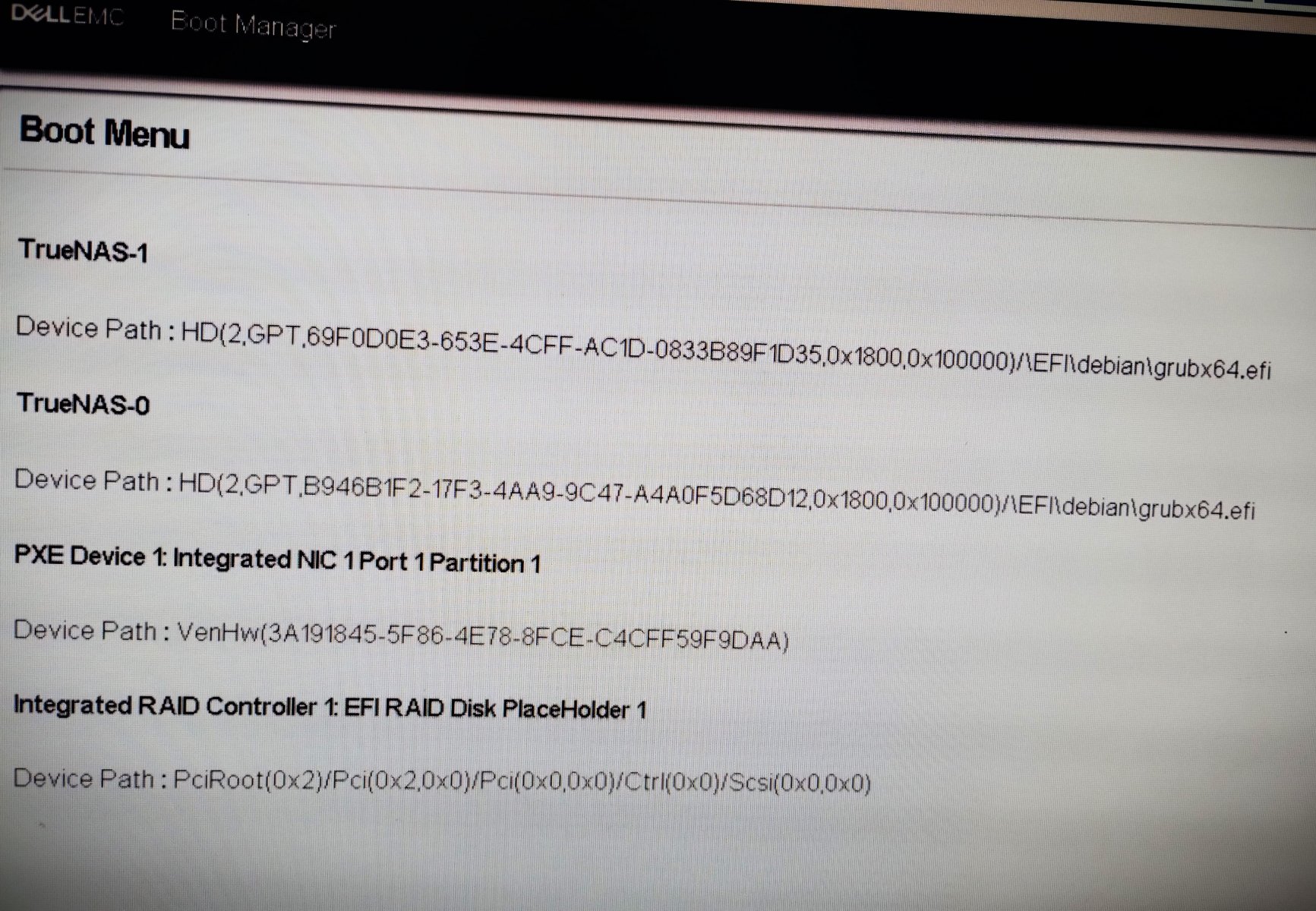

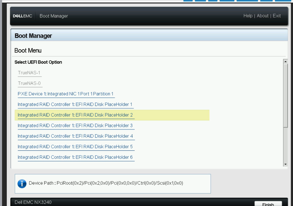

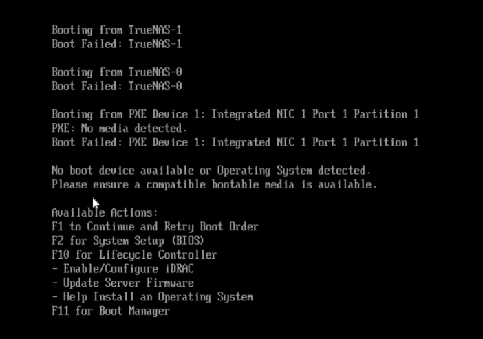

Device: DELL NX3240 Storage Server
Boot Mode: UEFI
Installation Target: Samsung 970 EVO Plus 500GB SSD X2
Problem: A Fresh TruesNAS on dual SSDs installed in the DELL Server. After removing the USB and rebooting the Server system TrueNas filaed to boot. Please have a look at the attached Images for a better understanding.
Although it may be unrelated to the immediate issue, that RAID controller that the system firmware is loudly announcing is not appropriate for use with ZFS.

The problem is Dell Server Bootloader is not detecting PCIE SSD as a boot device.
Yes, I have tried ZFS boot menu hack (using an external USB loaded with ZFS menu bootloader and running up TrueNAS) but it's not the Permanent solution because you reboot the Server every time the USB should be attached to the server.
I have contacted DELL Support but they didn't help because this PCIE SSD card is a non-DELL product.
That's what the internal USB port is for.
