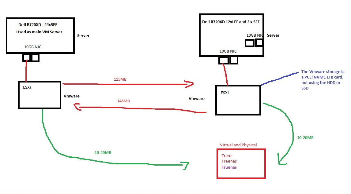

Where did you get the card from, and is it showing link at 10Gbps?
There are a lot of fake Intel cards out there. Pull the card and validate the Yottamark. If it doesn't validate, or doesn't have a Yottamark, it's likely fake and isn't expected to work well.
Generally speaking, copper 10G is kinda tragic and there are more things to go wrong. If you can, get rid of the copper and go to fiber. There is a great 10 gig networking primer elsewhere on these forums in the resources that list a variety of things that are known to work swimmingly well with less drama.

See, but you're not giving me much to work with. If the hardware is actually okay, which you still need to validate, then the other usual problem would be that you're trying to do ESXi block storage on RAIDZ, probably on a datastore that is fragmented and/or relatively full.

I really appriciate your efferot int trying to help me and in no way expecting you to do the running for me. I just dont know what information you want/need?
I hope the following helps:
as per the image copying between the ESXi servers, is no where near 10GB speed but its bearable. However, when i use anything to do with Truenas/Freenas the speed drops to the speed unberable. I tried both truenas on baremetal and truenas as a VM did not make a difference.
This is a new install, the storage i used for testing is a single drive tried both SSD and HDD. wanted to test the speed and make sure its working ok before doing it properly. Therefore the SSD and/or the HDD is empty to start with. Also tried using raidz2 with the rest of the drives but the results were the same.
