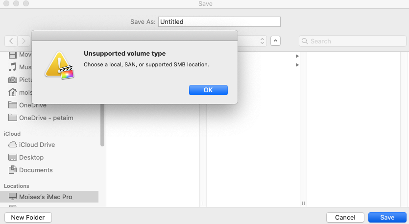

Unsupported Volume Type
Choose a local, SAN, or supported SMB location.
This message shows up when I try to open FCPX file, anyone knows whats going on?

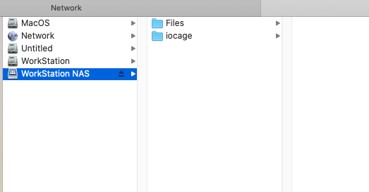

Is the network drive the FCPX refers to mounted in Finder?

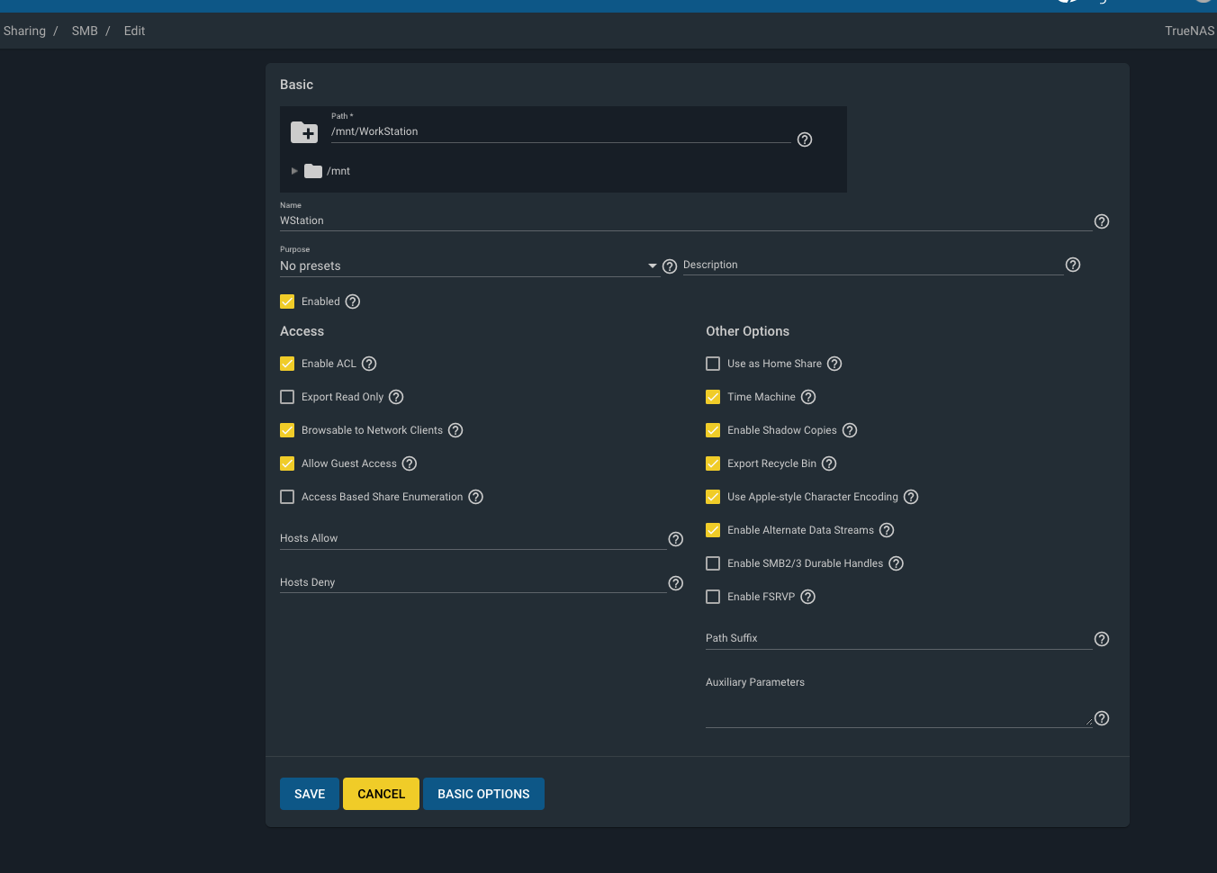

Should be in the same location: Sharing->Windows shares. Within the share, enable VFS fruit. Restart the SMB service to make it take effect.

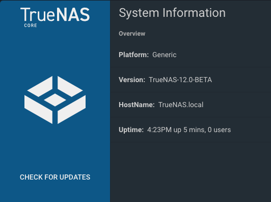

What version of TrueNAS is this, and are you running in HA mode?

Don't forget to restart SMB service after changing its settings. You may also need to unmount and remount the share.
