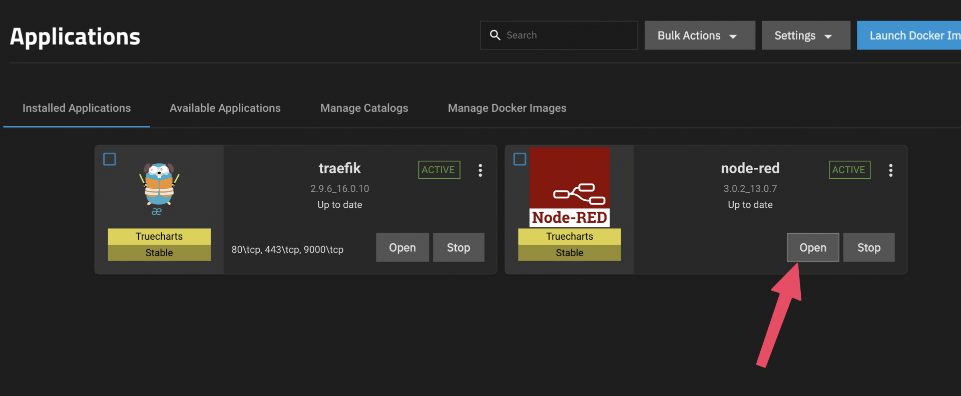

Strangely, the hostnames don't work. Basically, if I click the "open" button,
I get redirected to the correct host name, but getting an error [DNS_PROBE_FINISHED_NXDOMAIN].

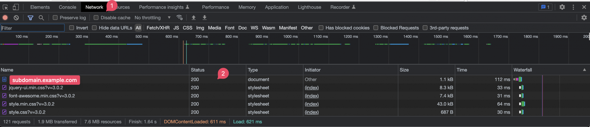

  2. Opening your subdomain via the network tab in the dev console and checking if there are no 301-308 staus codes

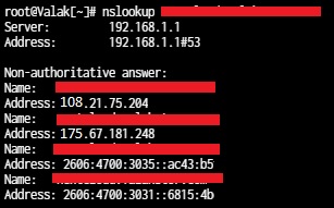

Hey there,
Thanks for reaching out. Ok so I did what you asked, I did the NS lookup in shell and this was the readout.
I also checked the network Tab on Chrome and the Subdomain is getting a code 302.
Just as an fyi, I runs Pfsense firewall at 192.168.1.1. Is it messing with my DNS resolution ?

so I assume the 175.67.181.248 is your second IP in the TrueNas network through all your apps a running. The 302 indicates there is a redirect, have you checked this?
Hey,
The second IP is something TrueNas is handling as parts of the system I would imagine. I will look at the resource you linked which looks to make sure that Pfsense is capturing and processing all the DNS requests rather than an outside source. Let me put that into place and see what we get. Update coming soon.
