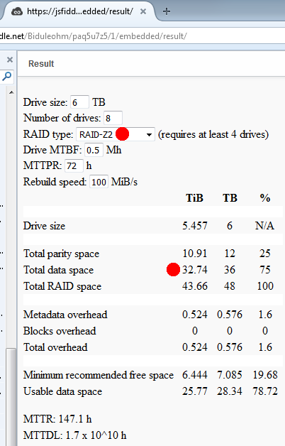

Where did you get that 28TB?
If I use Biduleohm's calculator it states "Total data space 32.74TiB", see attached picture.
I know that I should only use 26TB (80%) of that size, but "zfs list" output shows a pool size of 26,8T, which I still don't understand.

Nope, I read the wrong thing, that is why I don't use that RAID calculator. So you should have 32.7TB of usable space minus 16GB for SWAP space, so still 32TB. I can see your delima, it does look like you are missing 2TB of storage however I'm sure it's the inefficiencies in the formatting of the partitions, possibly not on a 4k alignment.
